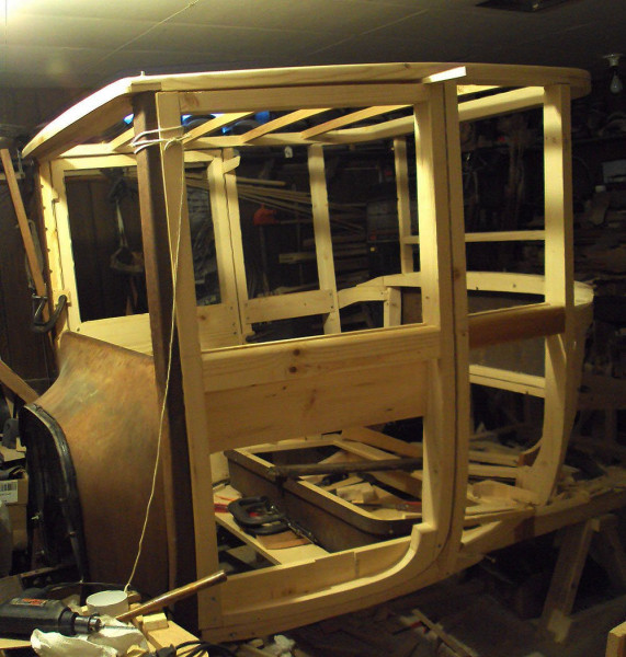

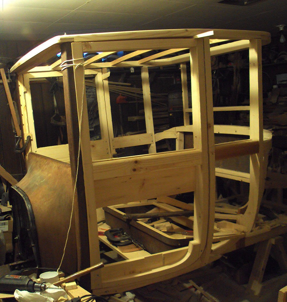

I rewooded my 22 T Coupe with pine (2X 4s) in 2012. It has not held the nails and tacks as well but is still holding up well. It was much easier on the tools. I had not planned to drive it much but we have about a thousand miles on it too.

Obviously I don’t know your skill level, but having done a number of wood jobs without drawings, I recommend doing a first go using some cheap disposable wood while you get comfortable with the order of cuts and the angles etc. once you are comfortable with how you are going to proceed, then grab the quality expensive chunk of wood!!
I have done a centre door, a fordor, a Detroit electric and a 15 touring!!
