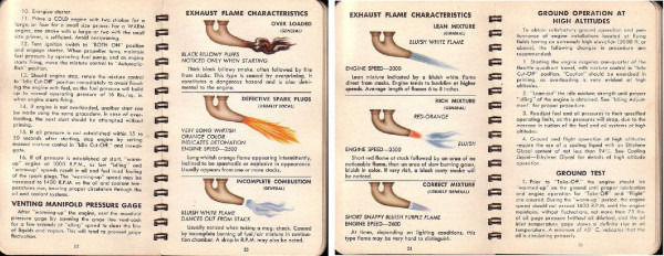

Interesting that the question of coloured exhaust manifolds come up on occasion. May I suggest that a review of an training manual from WWII be reviewed. It may help with the manifold colours and the flames. (exhaust colour Allison V-1710)
