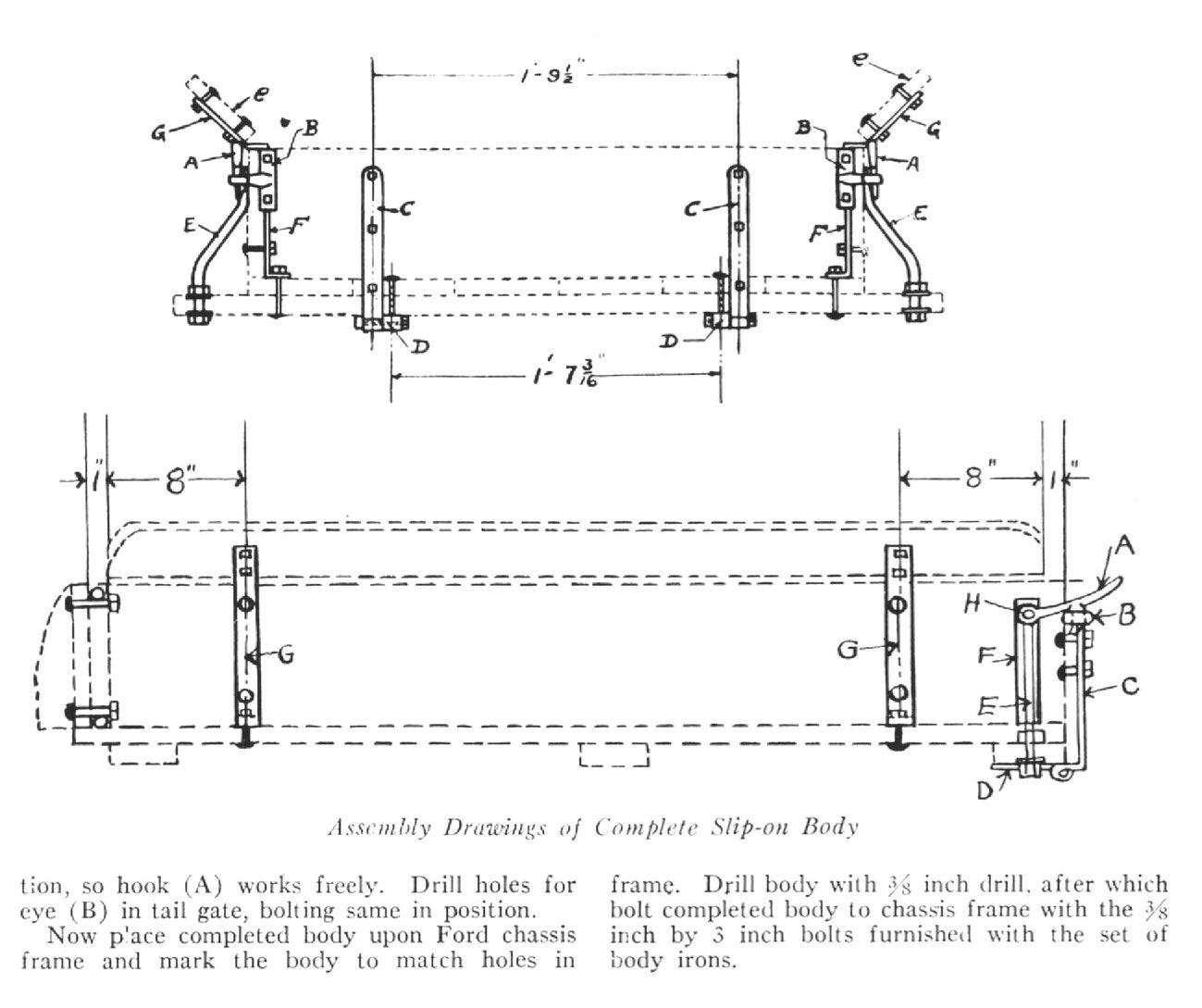

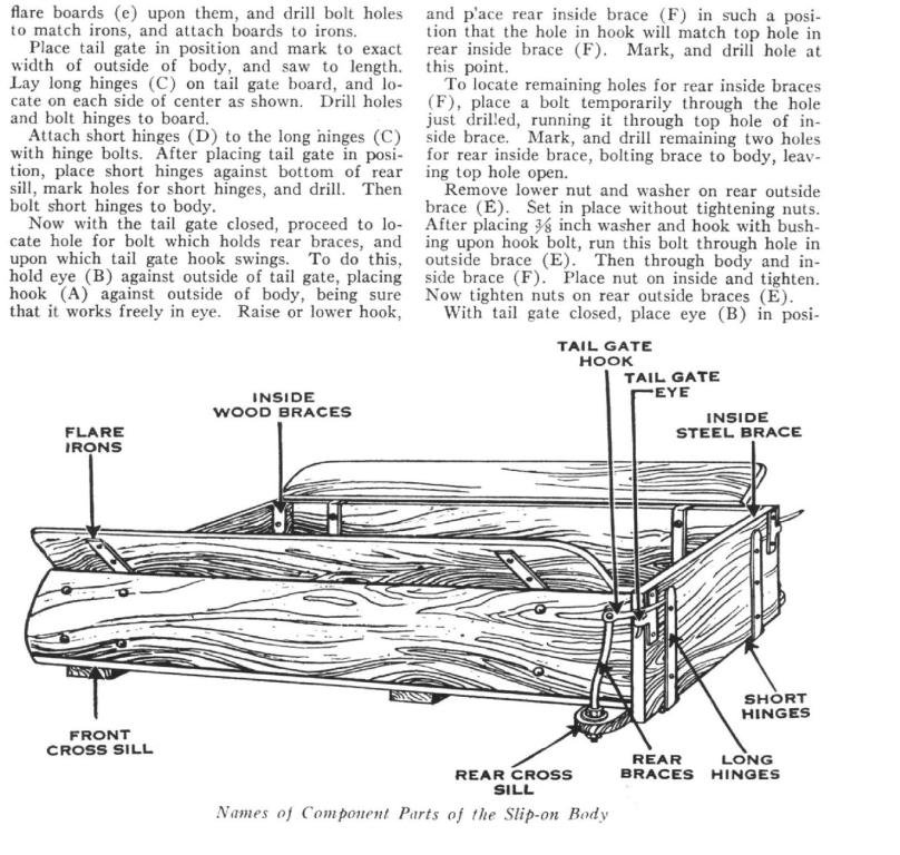

Is there a source for plans to build a 14-22 pickup box? Seems like there were plans for sale from a vendor to build a wood box with steel hardware for a while. It was a copy of a popular accessory box that was available for the Runabouts. The vendors have them in a kit but was wondering about plans for one. Thanks

Here is some information.

Thanks for that! Been thinking on building one or something similar for my 19 Runabout. The kits that are avaliable have oak as the wood that’s used. But I have have a feeling that other types of wood might have been used. Or what people had that was avaliable.

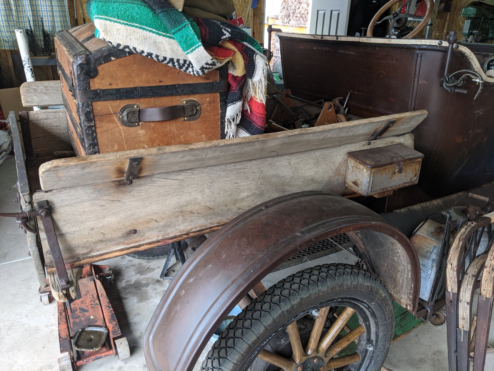

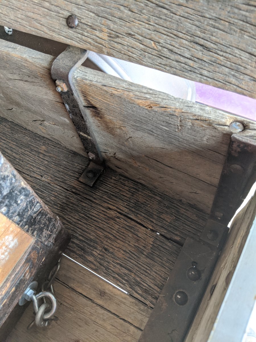

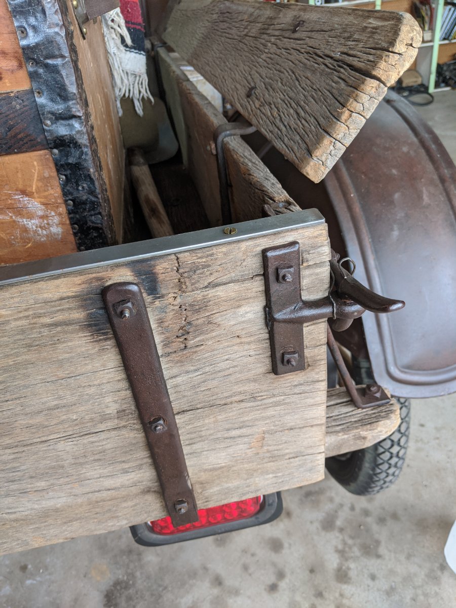

John, I also have a bed like the one in the drawings. (The rear braces appear to be the only difference). My bed was complete but very loose and rotten in some places. I was able to find some old wood from a re-claimer locally to replace some of the boards in the floor. Luckily the pieces I found were weathered similarly so they don't look out of place.
Originally the bed was nailed together then the hardware attached. Well 100 years later those nails did not quite do the job. I dissembled the entire thing, counter sunk some good wood screws in place of the nails and re- assembled the unit. I had to heat all of the nuts to get them off but is was worth saving them since finding matches is a bit of a chore.
Hope these photos are of some help.

Thanks for the pictures of your original pickup bed. What’s interesting is the small toolbox thats on the passenger side. Was it already on the box? I do have a tool box almost like yours that I think came off a 9n Ford tractor. Neat add on.
Also there is a manufactures no. on the hook latch for the box tailgate. All the iron looks fairly simple to make going by the plans copy and your pics. Lots of good info out there. Thanks
