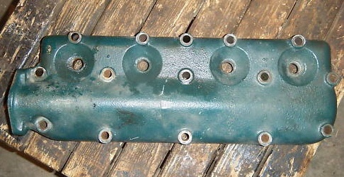

I have a cylinder head I removed from a '23 engine a while back - don't have the car anymore, so don't have the serial #. Wondering who, when, why was it cast without the beloved Ford script on top? Love that big "Ford" script bling looking at you when you open the hood! Any ideas??
- Posts: 4046
Re: Cylinder head with no Ford script
Home page, Club Encyl.
Other records indicate that in August 1926 the " Made in USA" and "Ford" were being eliminated from the head castings.

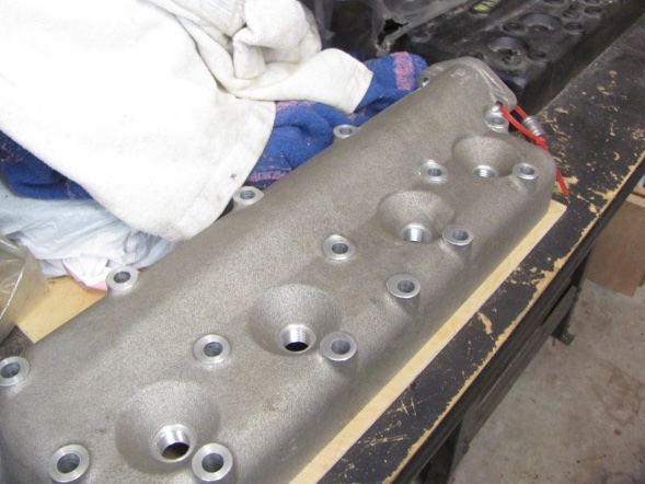

Well. have owned a couple of '26-'27s, and found out the later motors came with the 'bare' cylinder head!
And if you are placing a new high compression head, like the good Prus head, on a late '26, those are un-marked to keep cost down by no trademark selling price percentage fee to FOMOCO. So looks class judging authentic, but with more zoom
Prus high compression head

A coincedence you mention the Z head. I have a '27 Speedster (has a Ford script head - someone must have changed it before I got the car) and have actually been thinking about installing one, but have all but talked myself out of it since I'm not sure how robust the bottom end is and sure don't want to hazzard breaking a crank.
- Posts: 4046
Mike
If your rods and main babbitt is good, meaning no rattles or thumps now, shims left, and you have been running fine, adding a high compression head won't hurt anything in the bottom end.
Breaking a crank is a hazard anyway, with old cranks that are about 100 years old now. Don't think a high compression head is an independent circumstance of a broken crank.
While I haven't placed one on a used engine, only on fresh rebuilds, IMO, there isn't that much issue for a good condition motor.
