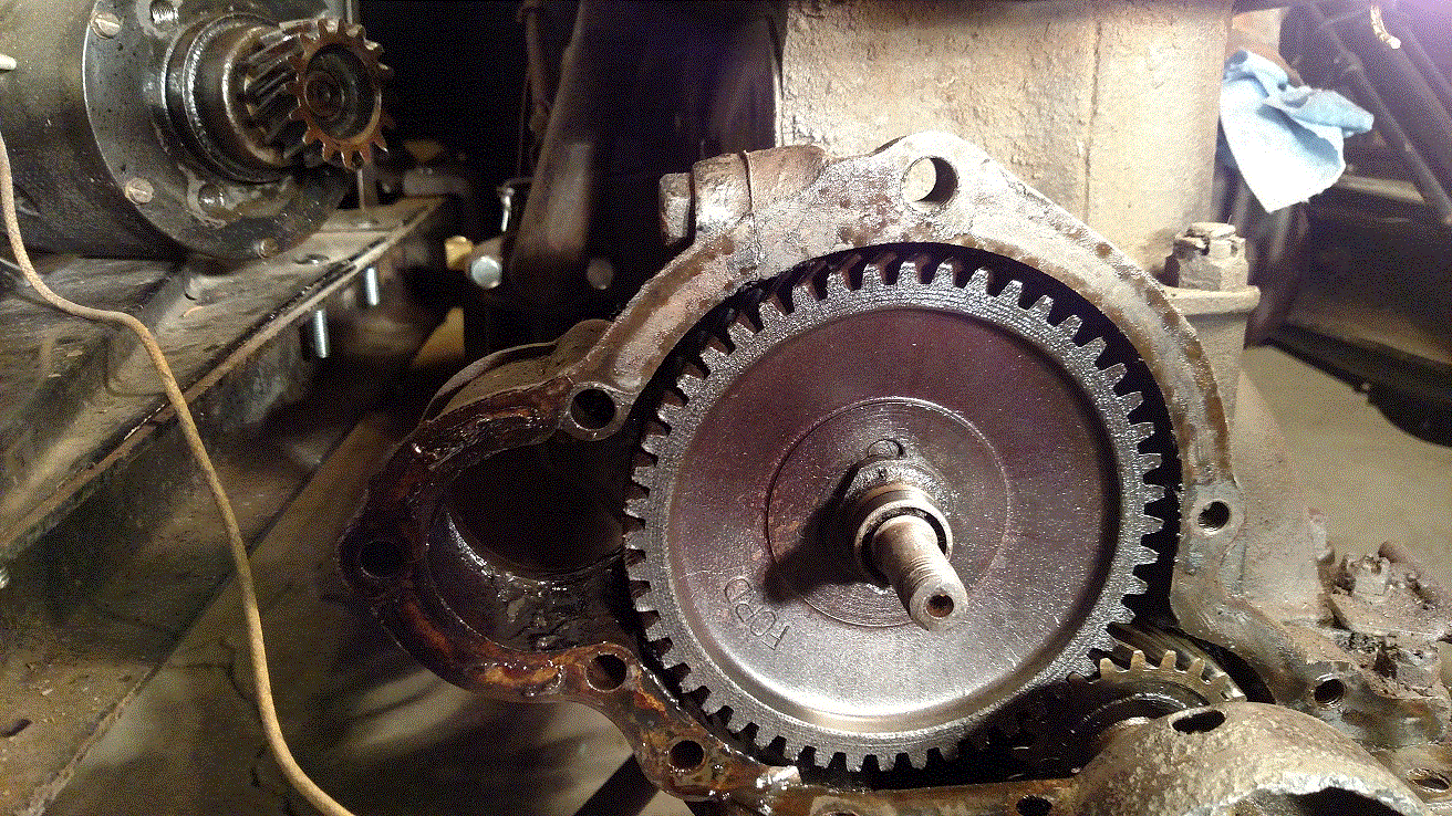

I discovered when I removed my timing cover that the engine in my ’26 has a fiber timing gear. While its teeth show little wear, I really don’t want to use it since I have a generator. I have seen enough ugly photos in past threads of destroyed fiber gears. At least my crankshaft gear looks new. I would like to read your opinions on the gears that are currently available.
My first thought was to get an aluminum gear. I ruled out the need for bronze since I have a stock engine with no need for higher strength gears. The vendors also sell nylon gears that come with modified cam nuts due to thicker material. These are available in a standard version and 7.5 degree advanced for more low-end torque. I have never driven my car on the road but I live in a hilly area so a slight torque improvement for no extra cost is appealing. I did not find 7.5 degree advanced aluminum gears but assume one could be modified for a price.
Are there advantages or disadvantages to using nylon? I assume that the thicker gear body is due to the lower strength of nylon compared to aluminum or fiber.
Is there really any performance to be gained from an advanced gear? I am certain that my worn out engine doesn’t have a modern advanced cam. The last time it was rebuilt or apart was no later than the 1980’s.

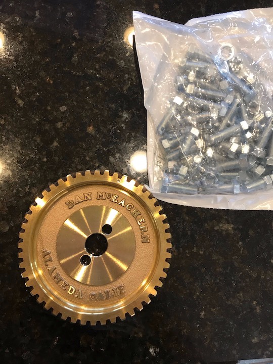

This is the one that I'm using. The one on the car is fiber.

The best on the market are DMC gears, you pay more for them but a whole lot quieter then the others, they are cut on the same machine so the gears run smoother. I like to show people the others out there and let them run the two sets together and they sell them selves from how smooth they are! Just my thoughts on this one.

Thank you for the great input. The fiber gear in my photo has a different shape than the damaged gear Steve Jelf showed in an older post. Mine also has "FORD" in raised letters that I have not seen in older photos. That may support a previous thread that suggested there were different types and qualities of fiber gears. Is the "FORD" version better or worse? I don't know so I intend to use aluminum unless someone can convince me to reinstall the fiber gear.

If the engine is quite worn, just leave the existing fiber gear which looks good in the picture, and then when you rebuild the engine at sometime in the future, you can replace both cam and gear with an advanced version of either the cam or the gear. According to your first post, it looks like you live in Nebraska. If so, what you call "Hilly" is not much. And to advance the cam might even lower your top speed performance.
