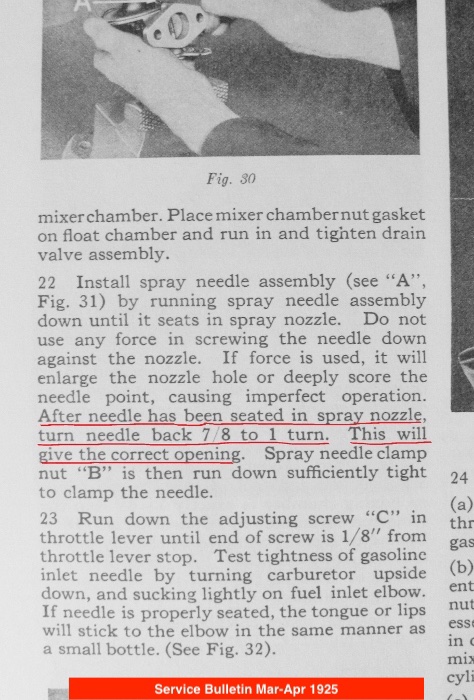

The Ford Owner's Manual is a useful resource too. Vendors supply reprint of these.
IMG_3361 (600x431) (580x417).jpg (159.35 KiB) Viewed 2807 times
And setting for initial starting of a fresh rebuild of the popular Holley NH, where the needle valve is new and new seat, these positions have worked the best IMO.
