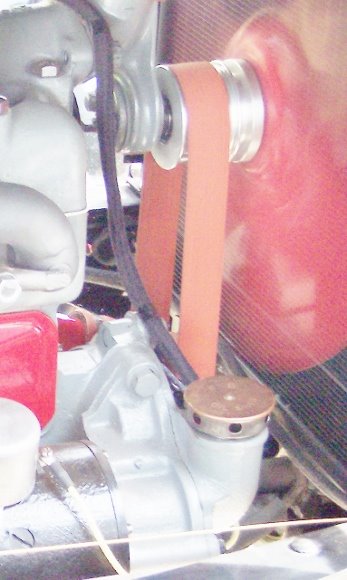

IMO, the modern fan pulley with sealed bearings is the cat's meow.
Have rebuilt the Ford alum pulley fan with new bushings, and new shaft. Proud of repair, pulley spun real free, and no wiggle. Added the heavy oil to the reservoir and went off touring. About 200 miles or so, terrible squeal from the engine! Wife wondered that we had engine trouble and got the cell phone out of the purse! Couldn't turn the fan by hand, took off the belt, no more pig squeal.
Found that the pulley bushing had seized on the shaft. Either my ream job was off, or belt too tight, or whatever, that fan was frozen up.
So opted to replace it with the modern one, no troubles for thousands of miles now. Good product!

I have been running one for over 10 years without a problem. Also rebushed with new shaft another T and have been running for over 20 years without a problem. I suspect your ream was off. Same thing can happen with transmission gear bushings.
