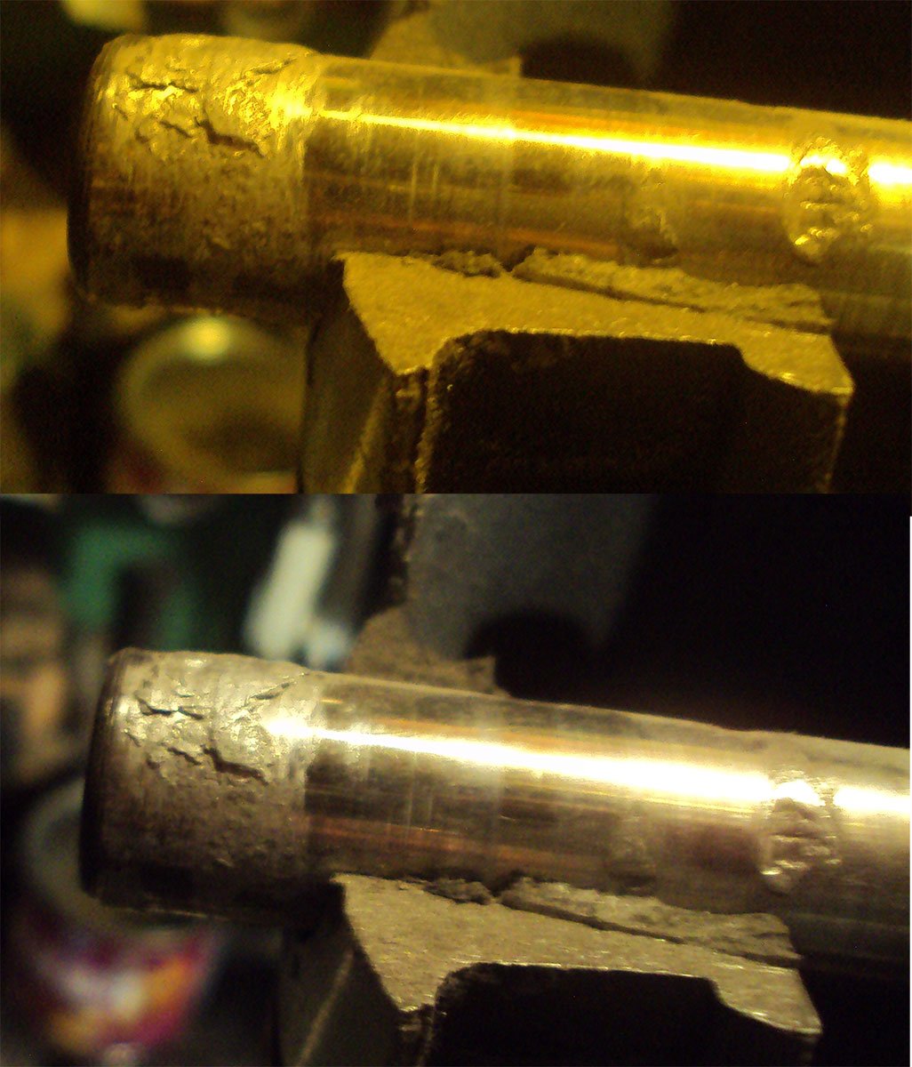

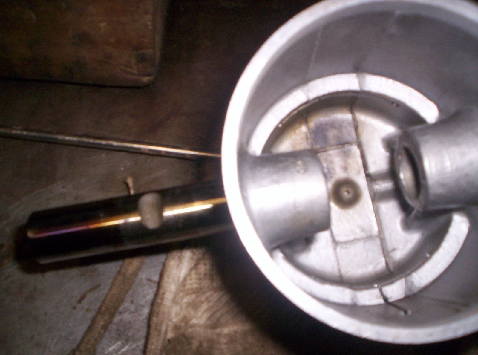

Just a reminder on why it's important to have oil holes in the pistons for the wrist pins.
Caught this engine, barely ran in, just in time. (Fitting a scat to it)

I have seen that on engines with the flywheel stripped, not enough oil being vaporized.

You need to check fit of piston pins before you put rods on. They need to be honed.

Dan is absolutely correct! NONE of any of the Model T pistons are ready to use right out of the box. They all have to be honed. Typically a regular automotive machine shop would set clearance on a piston like this at .0005”, but they actually need a little more than that. I generally set them up at .0008” clearance because the bores are generally a bit out of alignment and that is the point that the bores will totally clean up at. If a dry pin will not drop thru a dry piston under it’s own weight, the bores are too small or out of alignment. Oil holes are a secondary consideration. Without oil holes, capillary action will still properly lubricate the pin if the clearance is correct. The method of checking pin fitting in the Ford Manual is out of date. That was for an iron piston with brass bushings. A fit with aluminum pistons should be based on a precise measurement and feel dead free.

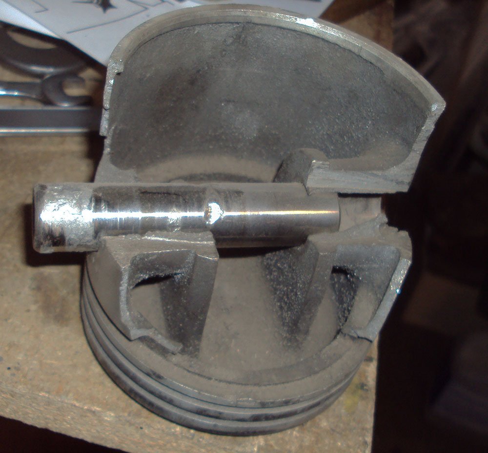

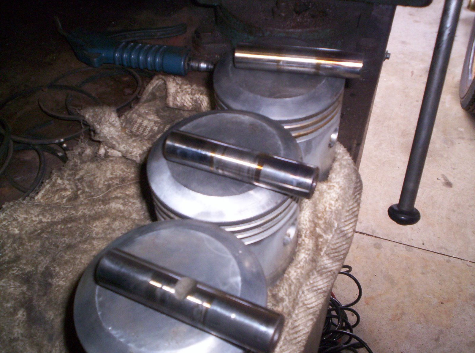

This piston locked up the engine and stopped the car. The pin bonded with the piston and I had to cut the piston to get the pin out to remove the rod. The other three never had a problem but try and buy one piston from a dealer.
Rich The engine ran fine for a few hundred miles before this happened. It was a very cold day but I doubt that affected anything.
I wouldn't have believed it if it hadn't happened.

RichIt was a very cold day
that had EVERYTHING to do with it
what was a too-close fit at 70F and too few miles to wear in, a very cold day would shrink the piston right onto the pin and eliminate virtually any boundary lubricant
holes grow more than pins when they heat up...what happens when they get cold?
