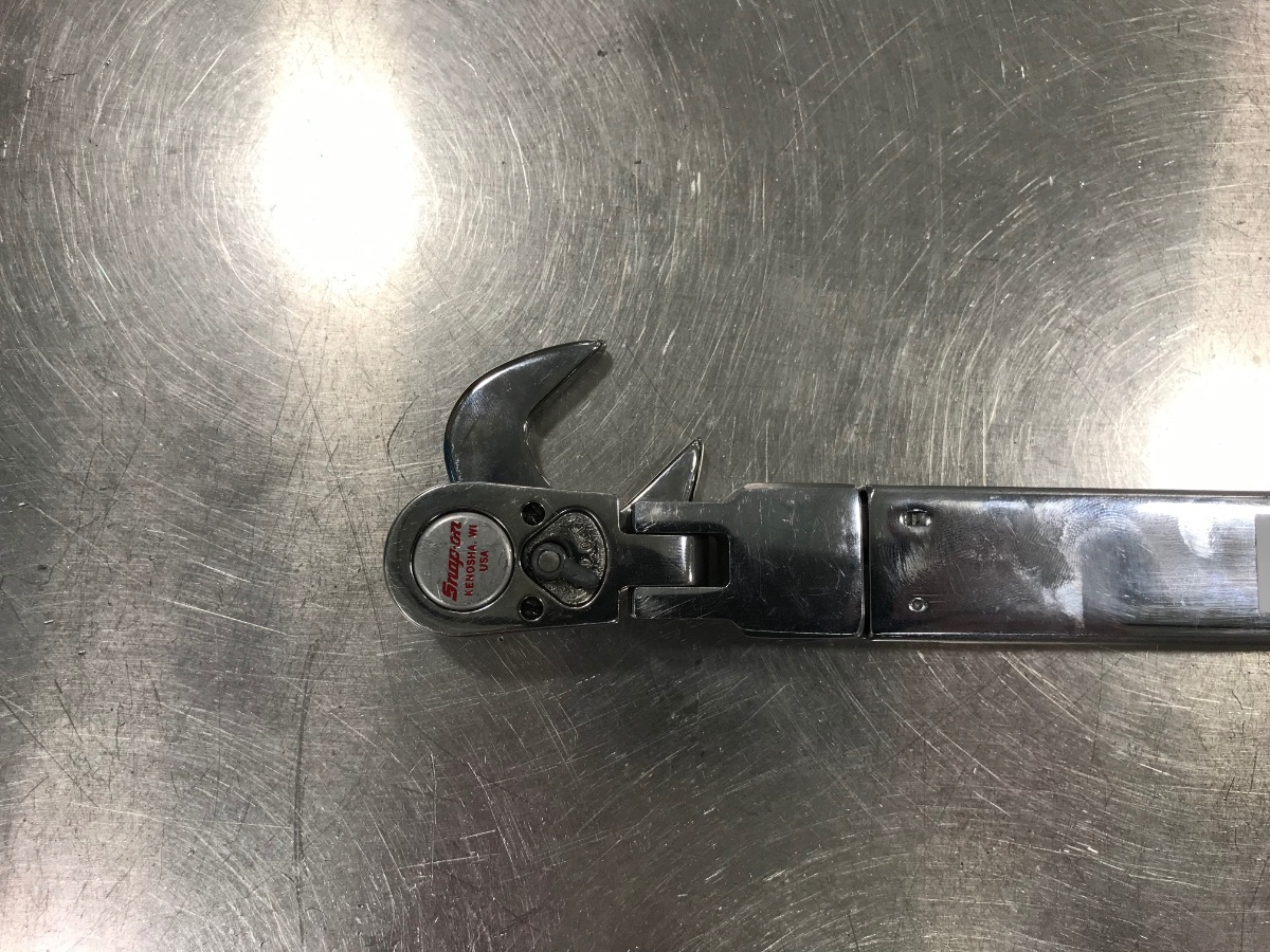

I use this , special for the three bolts on the back
