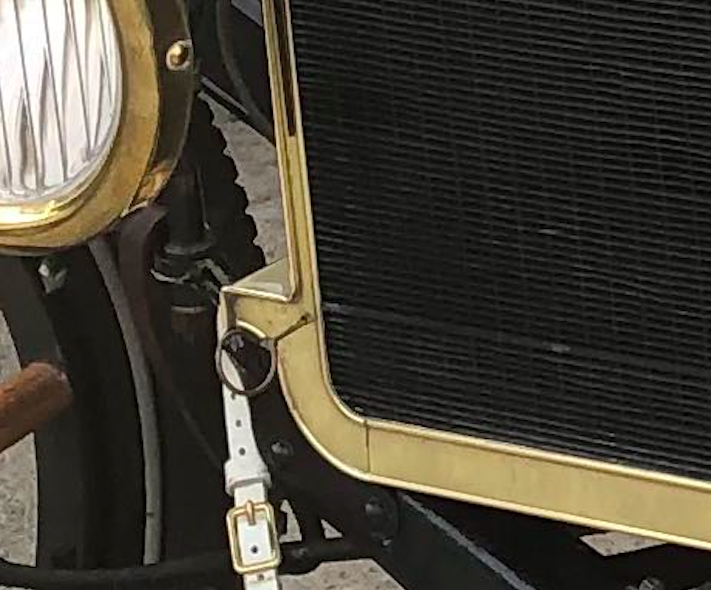

Did Ford relocate the hole for the priming wire in 1915? I've seen two examples of original radiators lately where the hole is slightly lower that was used previously. There is one pictured on ebay now too.

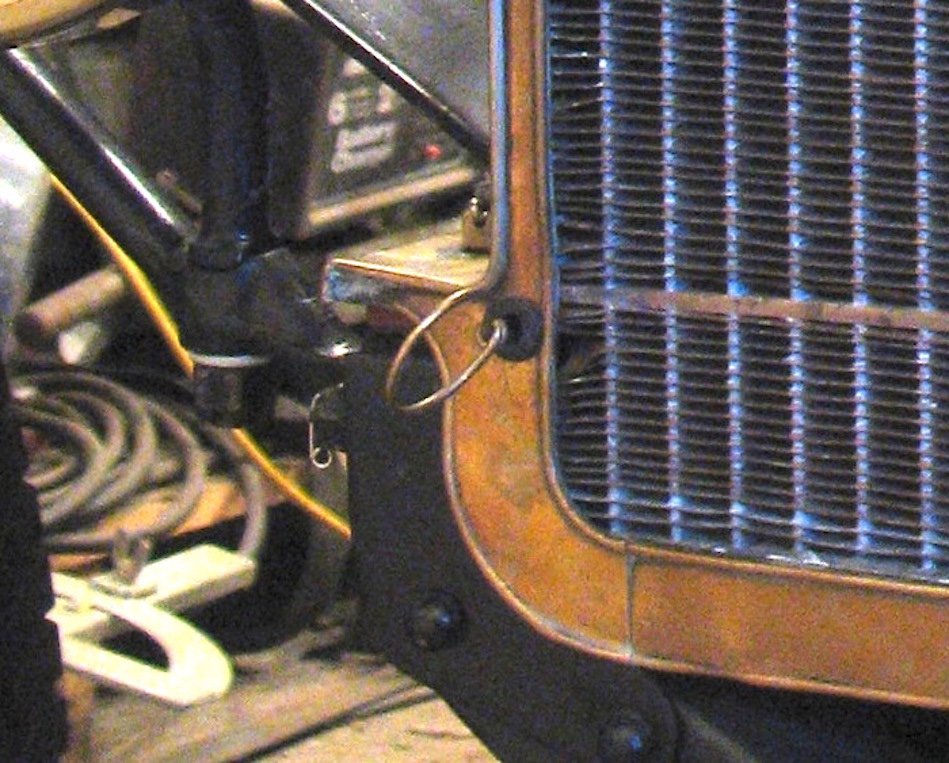

Here's mine. Not everything on this car is original, but I'm sure the radiator is.
Did Ford use a rubber grommet? I think probably not.

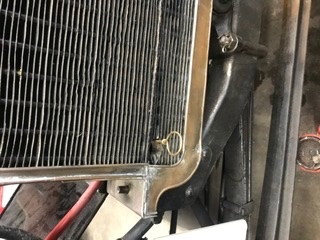

Where mine is on my 1915. May or may not be the original location.
