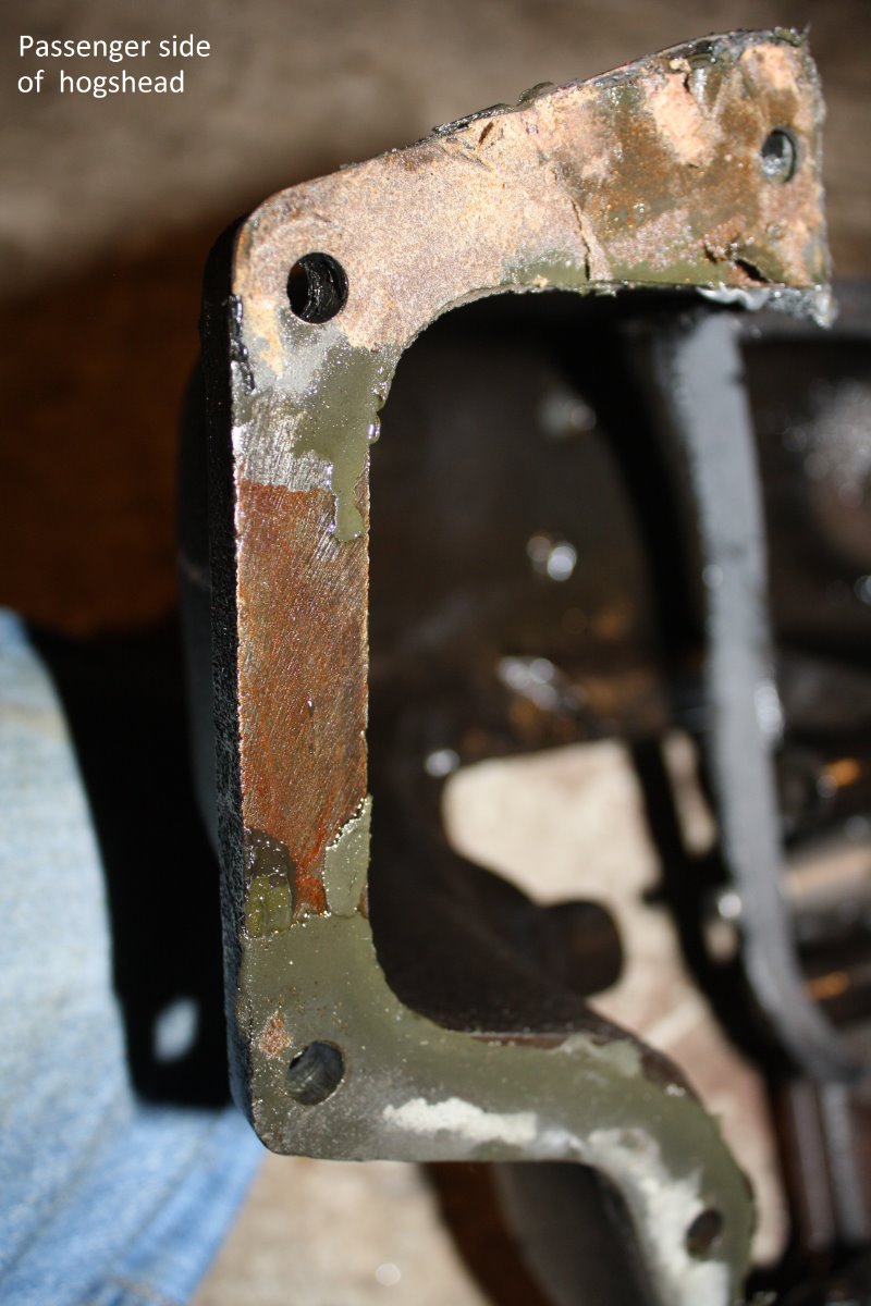

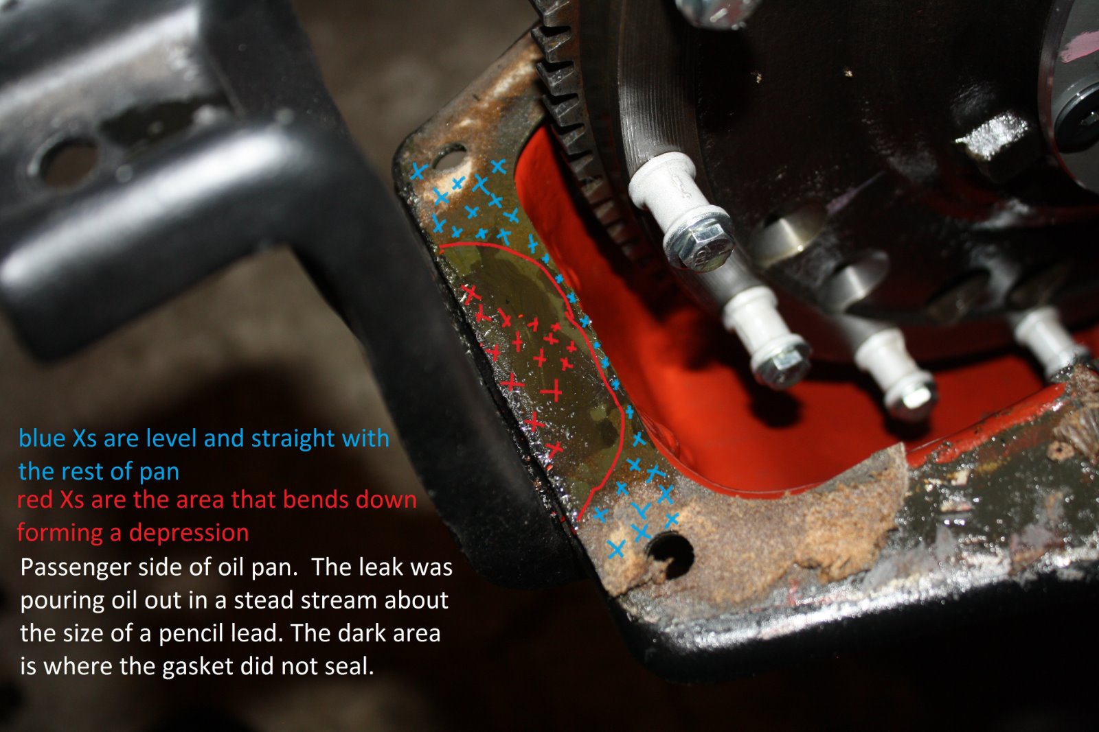

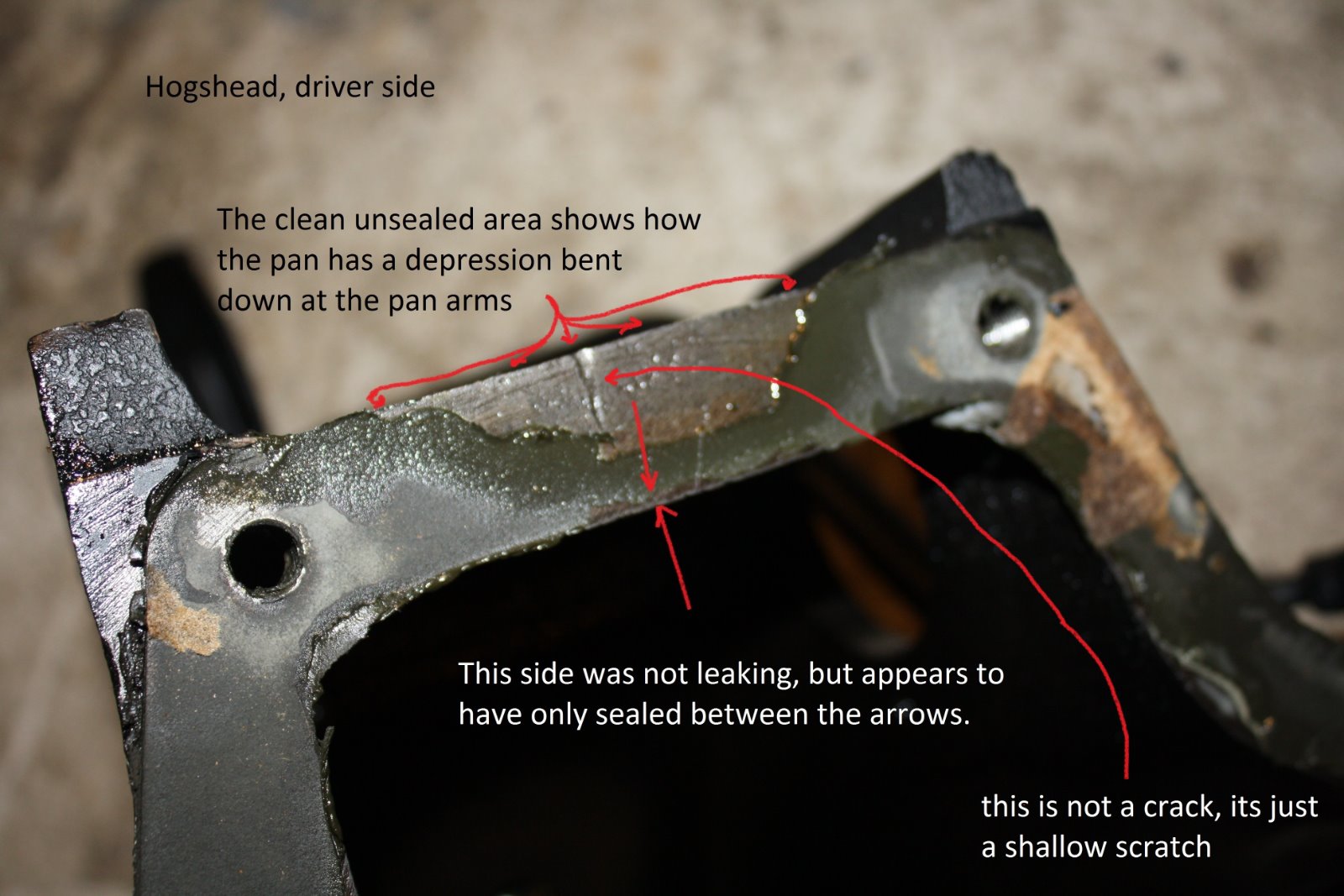

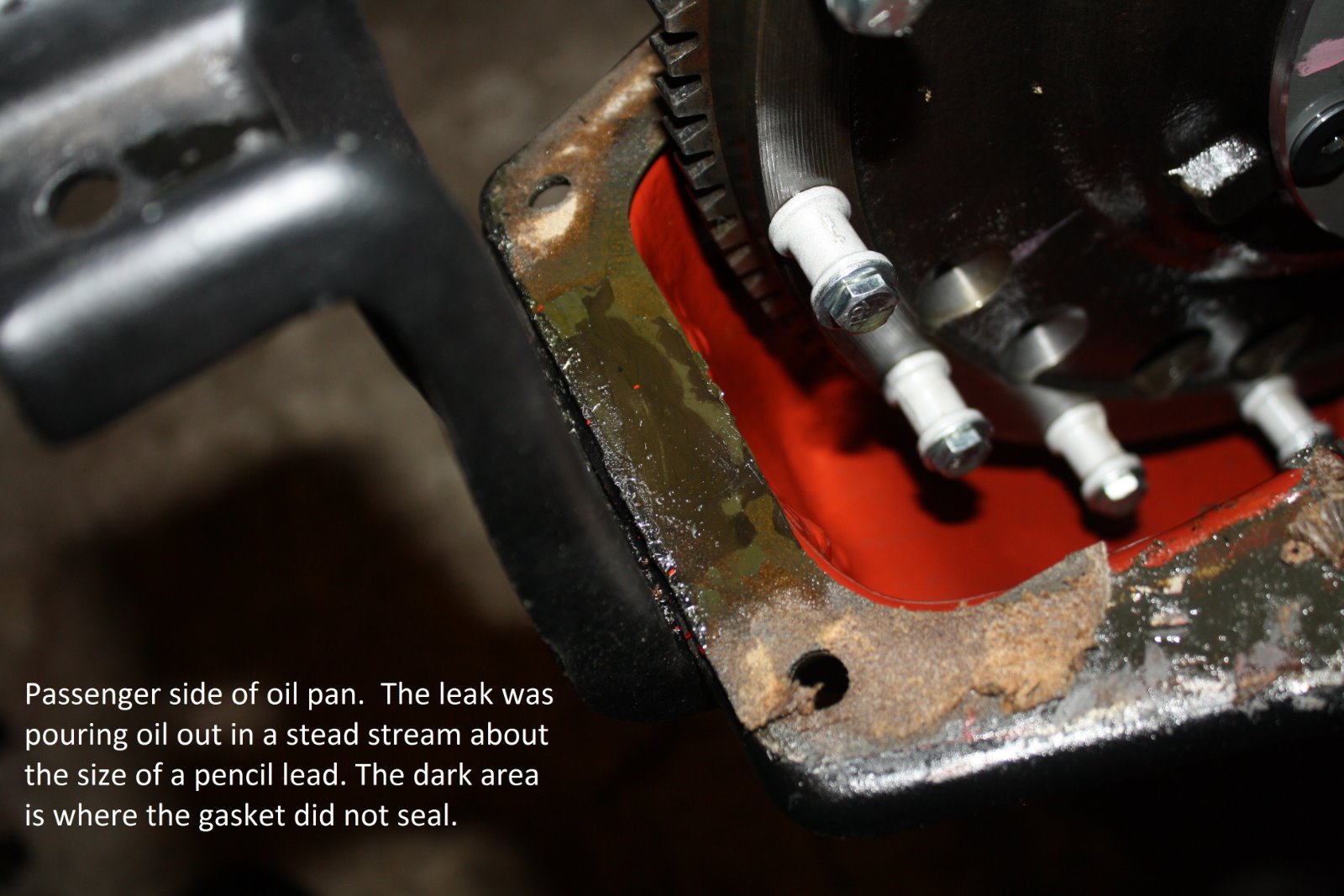

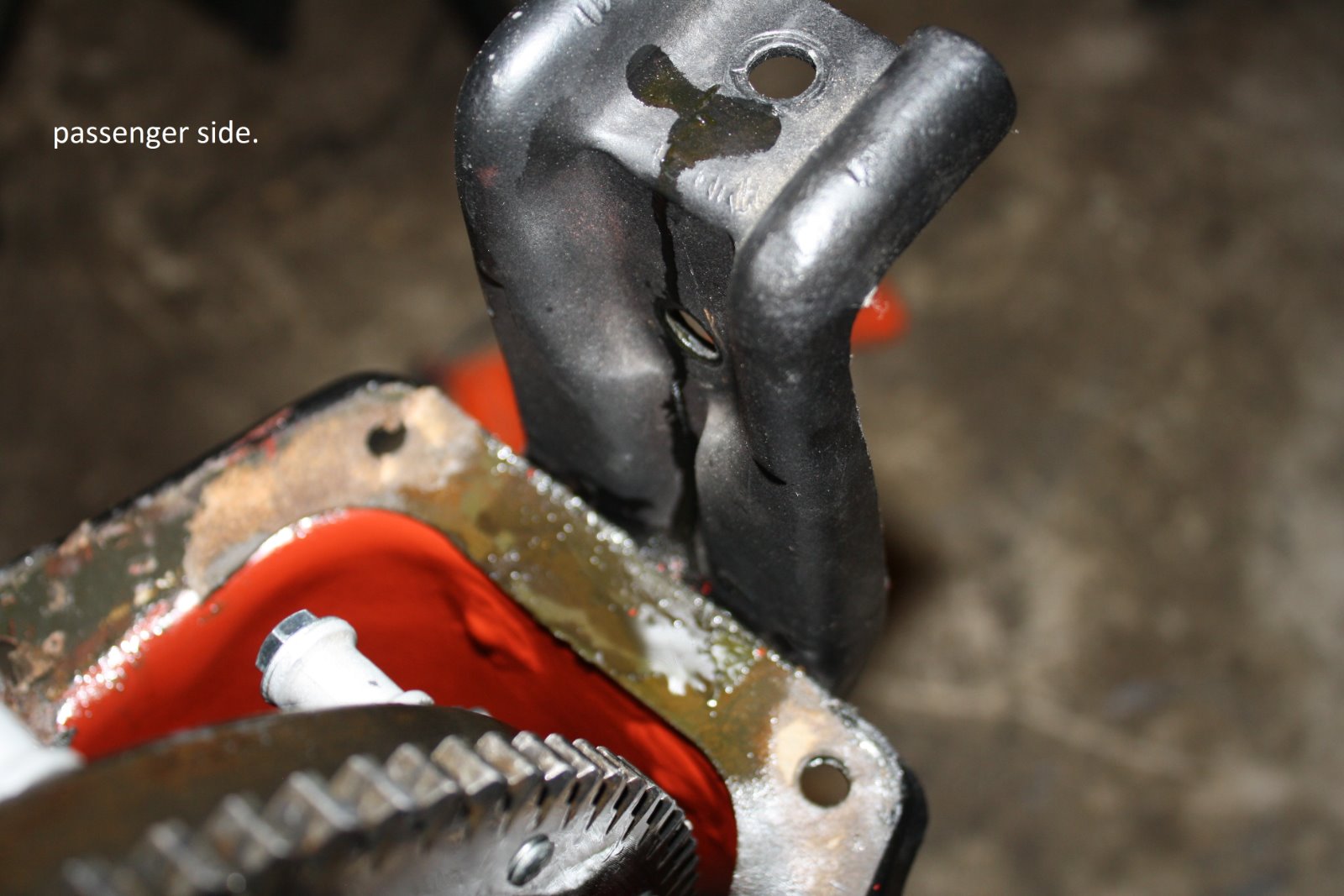

I have now removed the crankcase and I found the oil leak problem. There is a depression at the pan arms on both sides. If you use a straight edge The pan is straight just at a narrow edge near the inside of the lip. I have shown in the following pictures a area marked with blue Xs. That area is level with the rest of the pan, but sinks down into the area marked with the red Xs. There is not enough sealing area at the narrow strip marked with the blue Xs. But it explains why I missed the depression when straightning the pan on my pan jig. The narrow strip would be touching the pan and give a false reading when I tested it with the feeler gauge and shining a light inside the pan. That area is going to be almost impossible to straighten with the pan arm in the way. My pan has been modified for outside oil lines, and also has a small dam inside to slightly raise the oil level. So going to another pan is not a easy fix. Other than the two small depressions my pan is about as good as a person can find.

The pictures below were taken before I scraped and cleaned the depression area, and tested it with a straight edge. I forgot to take pictures of the cleaned up area, but these photos show the problem better than a cleaned up area would.....

Donnie, I would be inclined to tin the area thoroughly and add solder to fill the low spots. The heat used is not likely to cause any distortion problems. Once you have the area built up, a body file will make short work of getting it flat again. This way, you will only ever have to treat subsequent work in the usual manner. without the special steps you propose.

Just a thought. The pan arms angle out and over to go around the bolting surfaces. You should be able to stick a large screwdriver or steel rod in there (I know I have used a screwdriver to clean the crud out of that space). If you were to carefully heat the low area, it should expand down (guided by the already stretched area), then carefully pry it up while still cherry red (do NOT raise it too much!). As it cools, it should shrink itself nearly flat, hopefully without warping the pan much. Definitely, recheck the pan for straight on your jig.
Otherwise, your plan should probably work okay, but could have an increased chance of gasket failure due to the flywheel slinging oil right at it.
