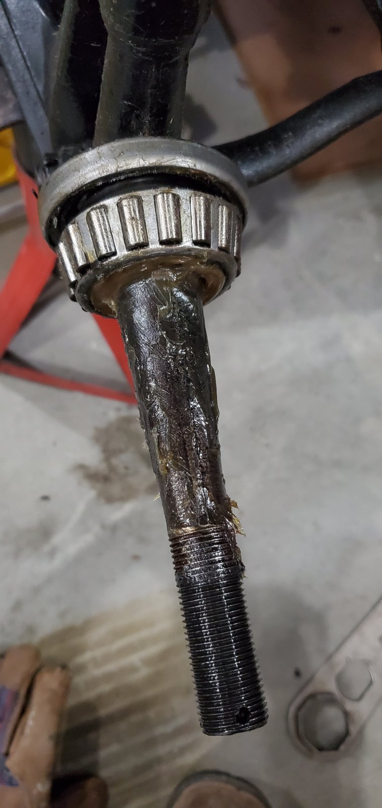

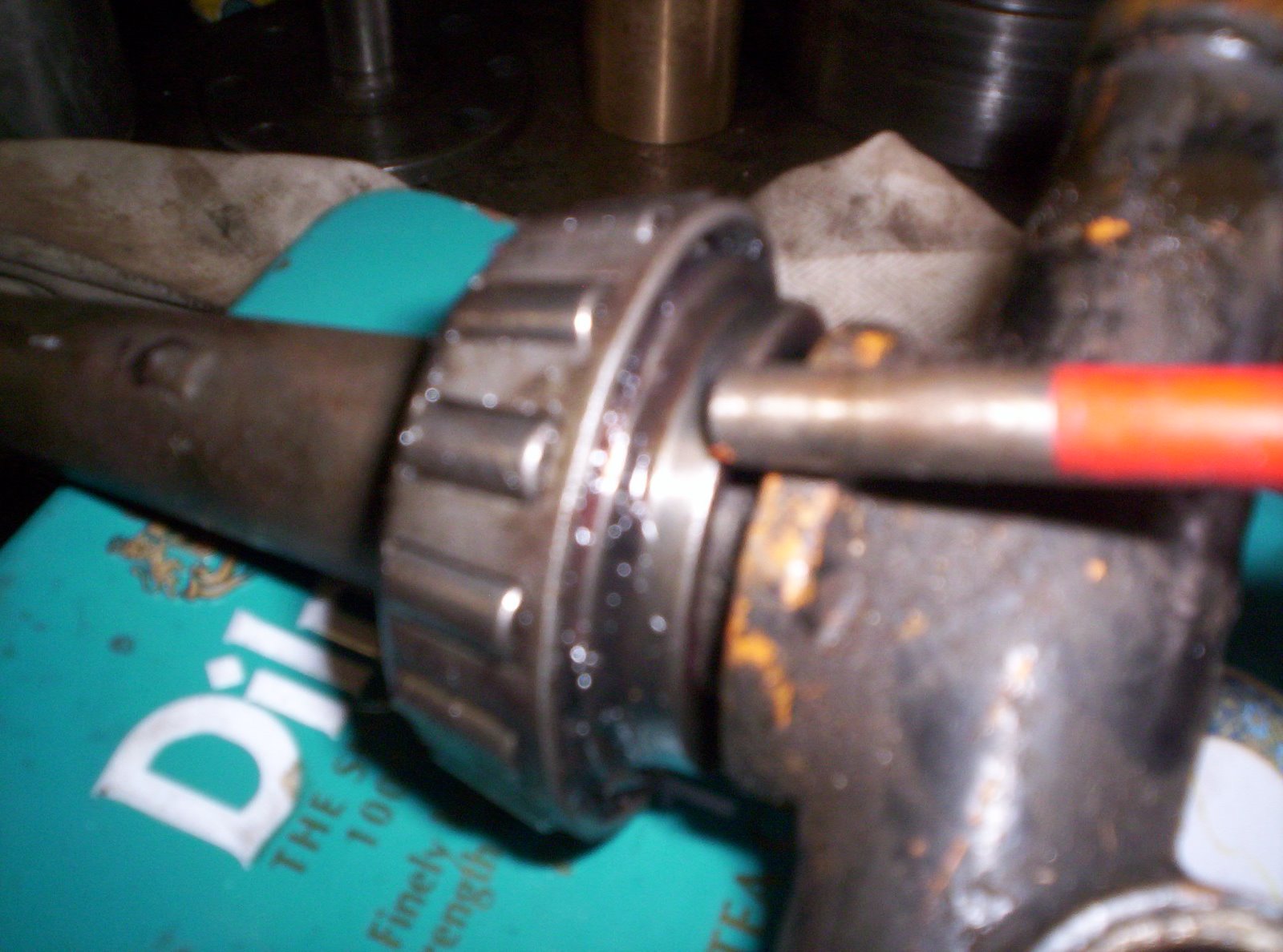

I am having some problems removing this bearing. I may have messed it up already trying to use my gear puller behind the seal and possibly bent the cage.
Any ideas? I know it is NOT supposed to slip on the spindle but this one is really tight.

Sharpen an old common screw driver, install behind the bearing and strike with a hammer slightly at multiple degrees. Should start walking out from the seal wearing surface. When you do get it off, take some machinist cloth and sand down the rough spot.

Chris, later stub axles have a flat spot either side to drift the bearing off,
if a early stub then start with a chisel, the seal runs on the shoulder on the bearing so it will come off with the bearing.

Thanks guys, I got it, had to move up 1 hammer size and filed a chisel down flat and pounded away.
I checked the bearing against another spindle and it slides right on.
I took some emery cloth to the spindle very lightly, it did not seem to have a high spot.

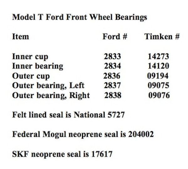

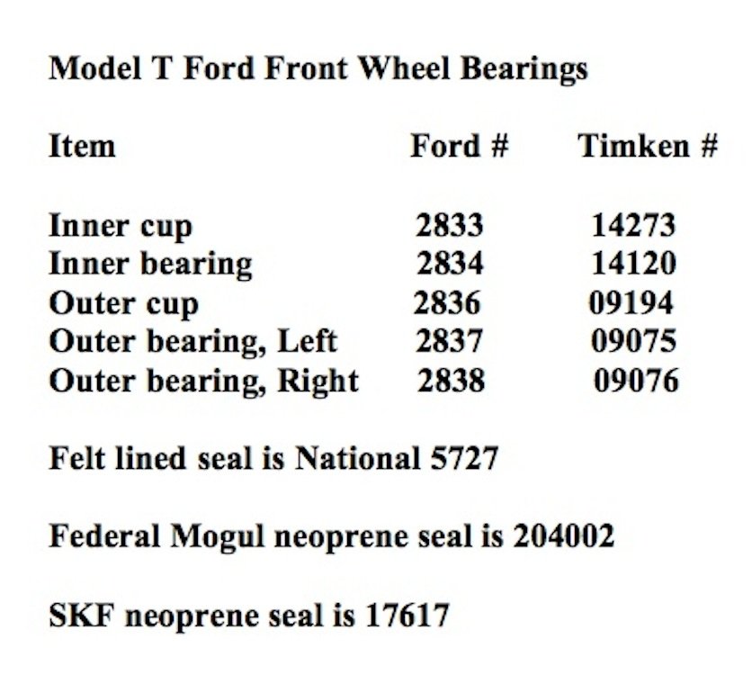

Some of my seal numbers are different.
