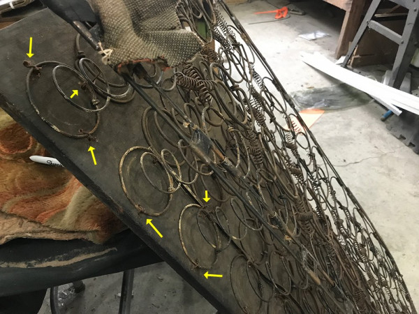

I'm getting ready to install a Classtique upholstery kit in my 1917 Touring. I've removed the old interior and am making some repairs and just got around to taking the covers off the old seats. The bottom spring for the front seat is in great shape but the rear seat is another story. The bottom frame is missing from the spring assembly with the coils instead wired to a piece of plywood on that side. Also, the top frame has been welded and repaired in a couple of places.
As I see it, my options are to A) buy a reproduction set of seat springs or B) replace the springs with foam. I'm not too concerned about authenticity, I just want something that will do the job. I plan to mount the springs or foam to a board regardless, despite the fact they were not done that way originally. One less place for critters to make a home.

The yellow arrows point to where the springs are wired to the plywood board

Re: Seat spring question
The current rear spring is missing the top frame and is a mix of coils as it is. I think someone cobbled it together many years ago. Looking at it more closely I think the top frame is missing and the previous owner flipped it upside down and wired the top of the coils to a board. It worked but there is no way I can justify covering it with new upholstery and putting it back in the car.
