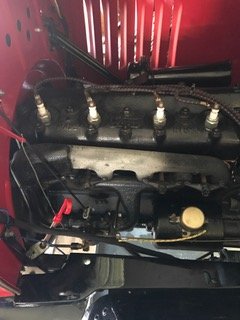

Took a first drive in a car I've been working on. The car has a new engine and after a 5 mile drive I noticed steam and spitting coolant on the windshield. When I got back to the shop, I noticed the exhaust manifold center section looked ashen/grayish in color, while the rest of it was black. Perhaps running too lean? (sorry about the sideways photo - I don't know how to rotate to orient correctly)

Most likely running lean and or spark too retarded. It definately was overheating.
- Posts: 4694
Re: What does this mean?

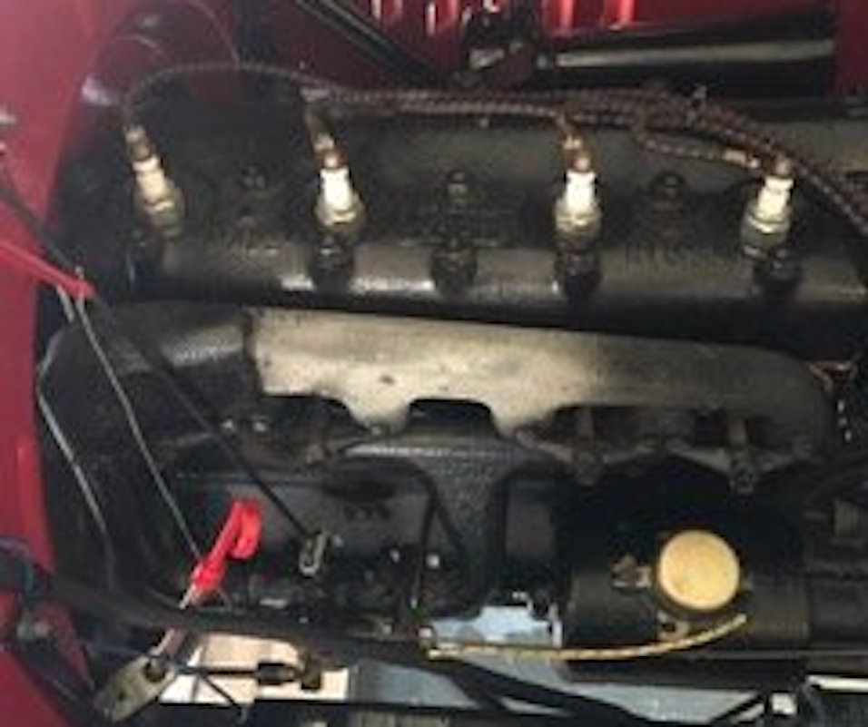

The picture is oriented correctly, but the manifolds look strange. Can you post another picture more close up of the manifolds.
- Posts: 7411
Blowing it up loses a lot of detail. A full size photo in a horizontal format would be better.

It certainly got hot, but why would only the center 2 exhaust ports be indicating a lean mixture? I'll have to work on the mixture adjustment as well as the advance. I'm running one of the Model T Ranch distributors and set it up as well as I could understand to the instructions. I hope I didn't hurt anything. Possible I have too much advance?? Appreciate the feedback.

You have 2 exhaust ports close together, the other ports are single and far apart. Exhaust heat from 2 close together means much more heat in this area.

You could have two leaking spark plugs causing a lean condition, before you adjust the mixture assure the plugs are not leaking, they are a pipe thread and don't seal that well.

You say this is your first drive on a new engine? It is possible that whoever painted the manifold did not use high temperature paint, and it's just burning off. As far as the spitting antifreeze, that would happen with an over filled radiator and a missing gasket under the cap.

Would also happen with a new, tight engine that has only 5 miles on it. Wouldn't hurt to check mixture & timing, but before you go off on another drive, just let the engine run for 15 or 20 minutes, shut it off, let it cool, do it over again till things loosen up a bit.JohnM wrote: ↑Thu May 14, 2020 12:01 pmYou say this is your first drive on a new engine? It is possible that whoever painted the manifold did not use high temperature paint, and it's just burning off. As far as the spitting antifreeze, that would happen with an over filled radiator and a missing gasket under the cap.
I agree about the manifold discoloration as well. May just be some "finish" burning off.

Looks like some discoloration on the engine head - not sure. But paint burn off is a strong possibility - using Engine Enamel on the exhaust manifold or not following the correct curing procedure
