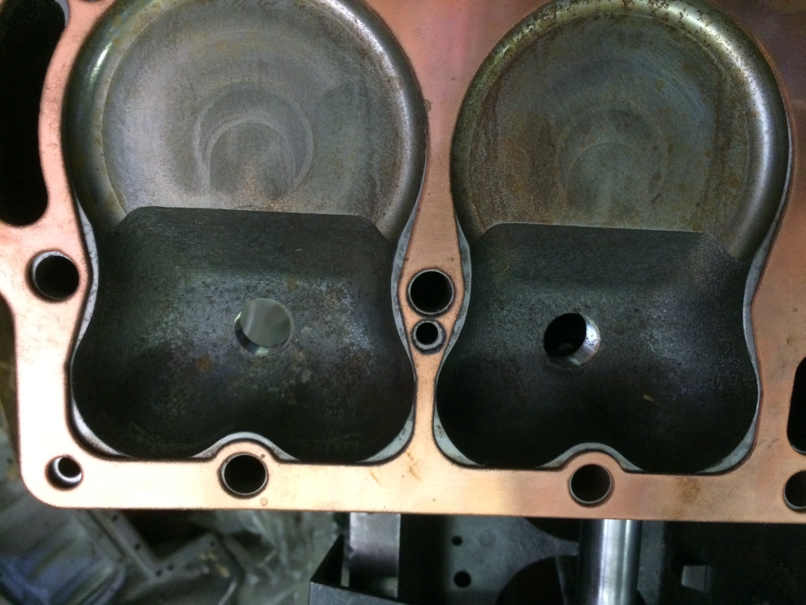

Good Day,
Slowly working away on my Speedster, doing a bit of fabrication here, a touch bad math there, some measure once, cut three times and it is still to short experiences. In general having a bit of fun. Came to the question of valves, the block I am using has been massaged a bit and noticed the valve holes aren't exactly stock. For those who have increased the valve sizes, beyond...just oversized, what did you do? I am assuming I should run hardened seats. What did you do about the valves? Do you order the large valve kit from Mr. Yapp and cut down the stems and press in A guides? Do you try and find a modern valve with a smaller stem diameter and go that way? Have heard that 327 bowtie valves can work? Will try and attach a picture to illustrate my situation.
Thanks,
Doug
Thanks,
Doug

You can't put A guides in a T block- too large a diameter and A valves are way too long for a T block. You don't need to put hard seats in either. Look at using small block Chevy valves- Regular size intakes and use FI exhaust valve if your exhaust seats have been enlarged. Chevy valves have 11/32" stems and you should be able to enlarge the stock T guide bores.
I see the exhaust seats on your block have been enlarged as well- try FI exhaust valves in both the intake and exhaust.
Kerry

Modern valve, size 1.543 head dia, and .342 stem, (.030 over size stem from std T block) any bigger valves and you could have head gasket problems.
Agree with Dan, those seats will clean up. fitting new seat usually will warp the bore which wouldn't be a problem if you are re-boring the block as well.
part No 3052M

Kerry- pretty sure those ports are too big for the Langs valve.

Thank you Dan, are those “fi” exhaust valves? Or F 1? Doesn’t look like the guides have been touched.
Dan McEachern wrote: ↑Fri May 01, 2020 4:40 pmYou can't put A guides in a T block- too large a diameter and A valves are way too long for a T block. You don't need to put hard seats in either. Look at using small block Chevy valves- Regular size intakes and use FI exhaust valve if your exhaust seats have been enlarged. Chevy valves have 11/32" stems and you should be able to enlarge the stock T guide bores.

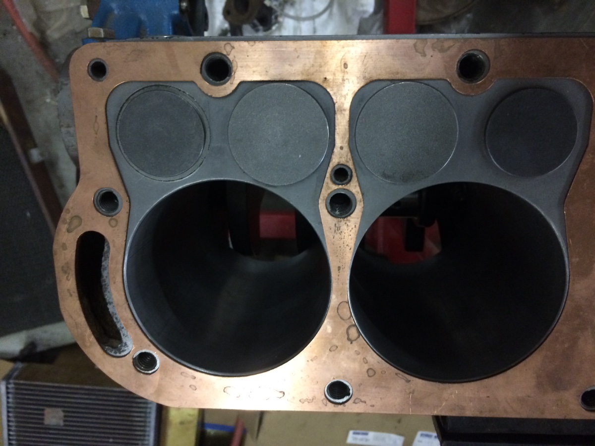

Here is another option
Fordson tractor intake valves. With my own head gasket
Prus head. It clears the valves nicely

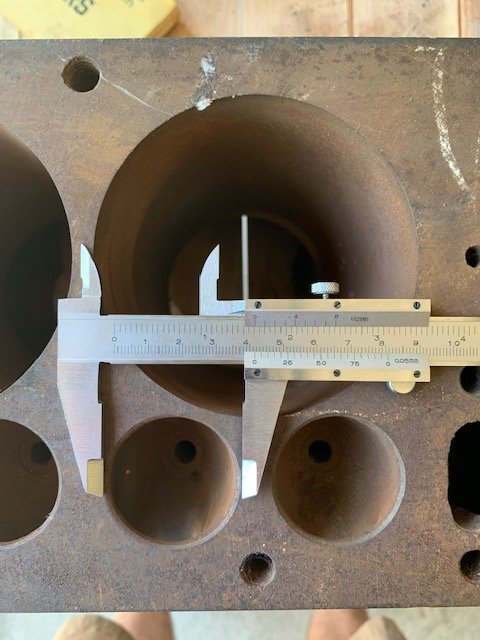

Think the block has been bored out. Calipers show it at 3.858 inches.
Kerry wrote: ↑Fri May 01, 2020 5:56 pmFrom Langs.
part No 3052M

Looks like you will have a problem with pistons, that's 108 thou over STD so you might be biting the bullet and do the lot on this block, new seats and cylinder sleeves and bring it back to using T parts.

I’ve been running 1.72” intake and 1.625” exhaust chebby valves for 10+ years in my Sherman head speedster. If I remember correctly, there is only 1 hard seat in the motor to repair a really recessed seat. The cast iron performs fine as a valve seat in a relatively low performance engine, but is also relative to the exhaust valve material characteristics. Sherman head profile was slightly machined to clean up and gasket was solid copper (your welcome for the CAD profile Les). I haven’t noticed any negative impact as far a flow characteristics. My little flatty keeps up with the OHV guys just fine

I have read and re-read all the posts on this thread. I am truly sorry if I seem to have missed the boat here BUT, the cylinder bore was NEVER measured with the calipers in the above photos. The valve seats/chambers appear to be the subject of the caliper measurements above. THUS, I am not aware of any cylinder dimensions that would or would not require sleaves.
The vernier caliper above appears to measure in both imperial (top) and metric (bottom) thus the measurement appears to be 3.858 centimeters.
Please accept my apologies if I have missed something in/from the above posts.
