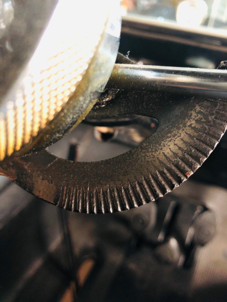

Wear on quadrant is normal and looks quaint. Just don’t thickly prime or heavy paint. Clean to bare metal and single shot of good black enamel.
Painted in 1988 and shows well the throttling of this T over time. :)
