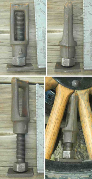

Terry- spoke jack? How about some photos of the tools and shims you use? I have steel felloes and demountable rims. My spokes are tight but I’d like to learn more for when I do have problems.

I suggest keeping all the parts of that wheel You are now set up for proper shimming as I discussed.
Oldav8or,
I have posted intructions indluding photos on how to shim metal felloe wheels and showing spoke jacks. With the change over of the forum there seems to be difficulty in searching the old posts for you. I was able to find a few on spoke jacks.

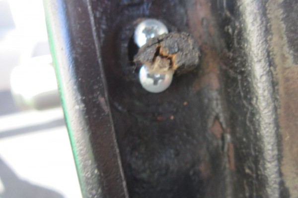

Here's how a previous owner of my 1920 T chose to "fix" the problem of loose spokes on a rear wheel. I opted to have all four rebuilt upon discovering this quite unexpectedly.

You can see how often I review old forum pages. I just saw the above message from Tim. Tim is a great guy who just gifted me with the upholstery he removed from his car... Rusty will proudly wear those seat covers...THANKS TIM!!!
Tim requested spoke jack tool photos so I have dug some up.
Spoke Jack in use
Spoke Jack in use
I also have a piece of rubber sheet in my tool box I put between the spokes and the jack to protect the spokes.

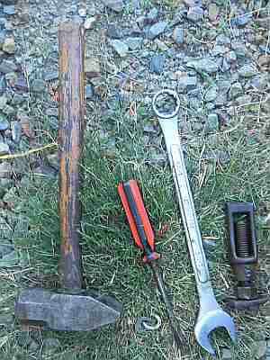

Tools
Tools
I use the hammer and the screwdriver for pushing the shims to place.

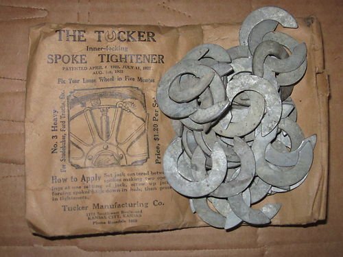

Shims made to carry in tool kit for wooden wheel Back in the T's hayday.tightening
These are shims available in the '20's and '30's. If you find washers thin enough you can easily make your own ... 1" washer with 1/2" hole is ideal. I have also cut them from shim stock. When you are stacking washer shims on all spokes you should think about spoke replacement.

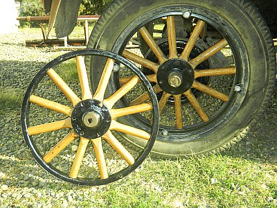

Spokes replaced
Spokes replaced
