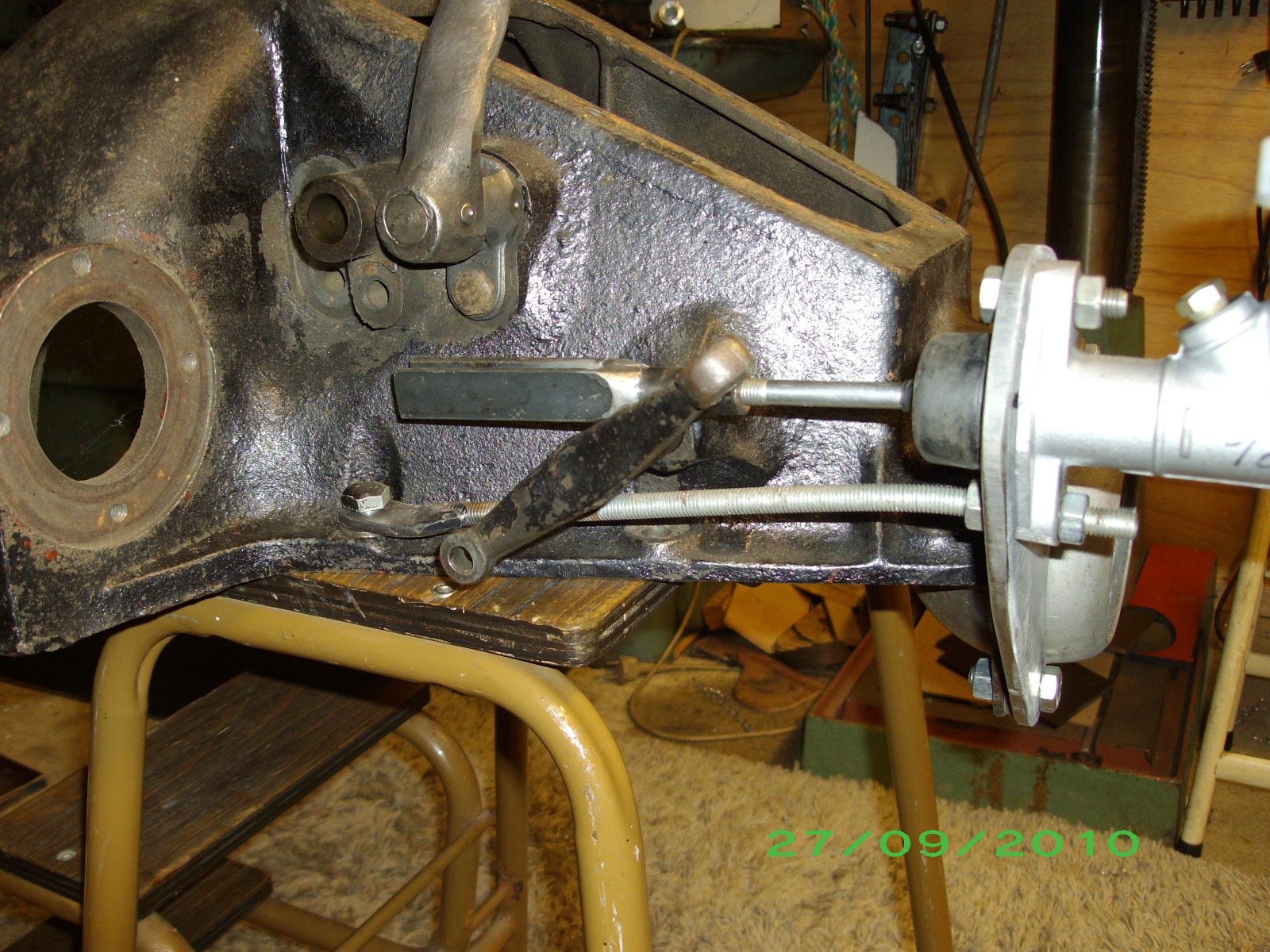

If you read down this posting there are links to how to mount/install the disk brakes. They show the rod you are talking about.

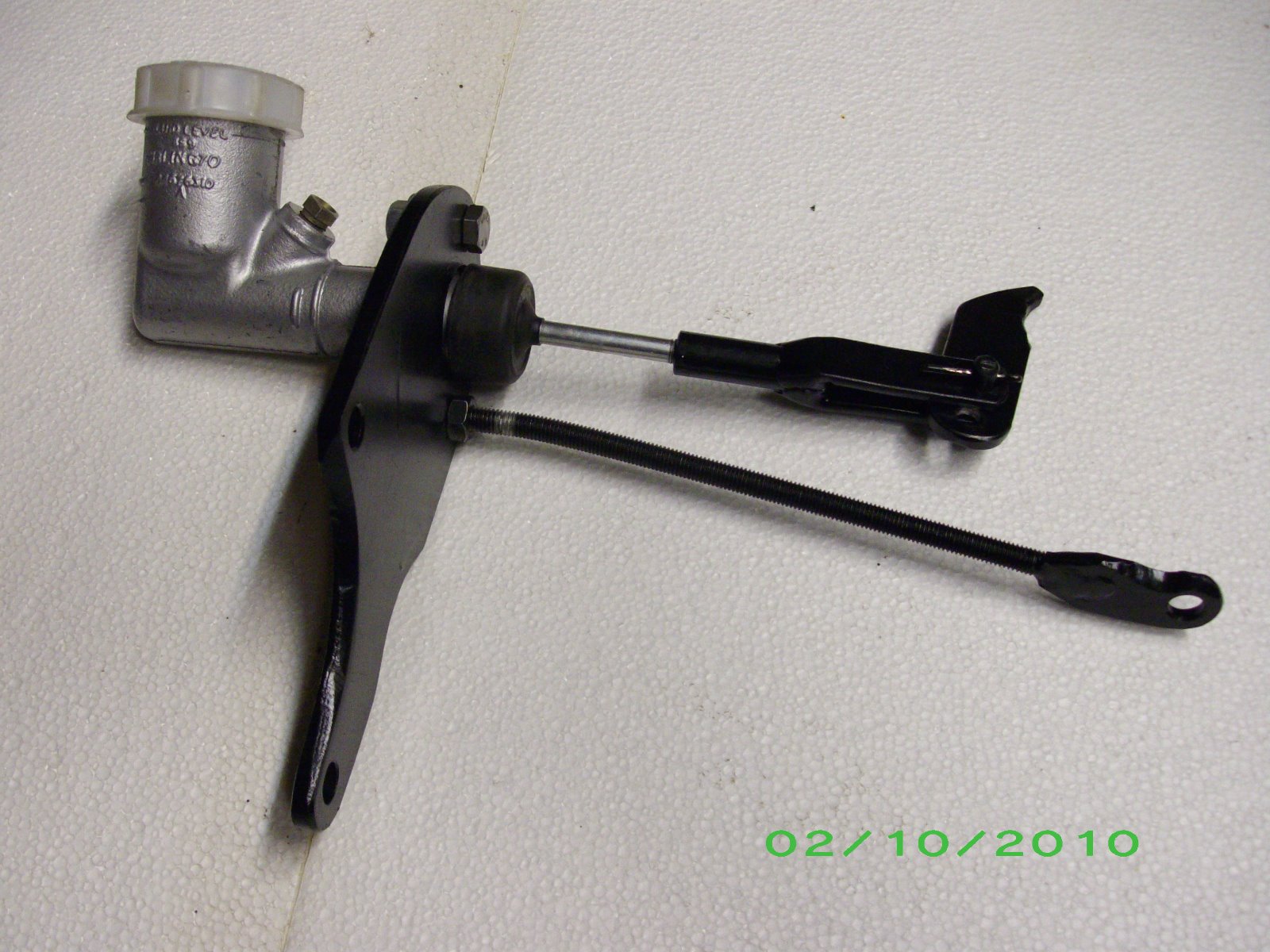

Tom ; do you mean this .

Yes, that's the rod. I just don't remember seeing it on current applications, such as some newer sure stops I have seen recently. I am going to put one on just to satisfy my own concerns. And maybe the newer ones don't require the extra support. Or may no one has noticed the movement.
