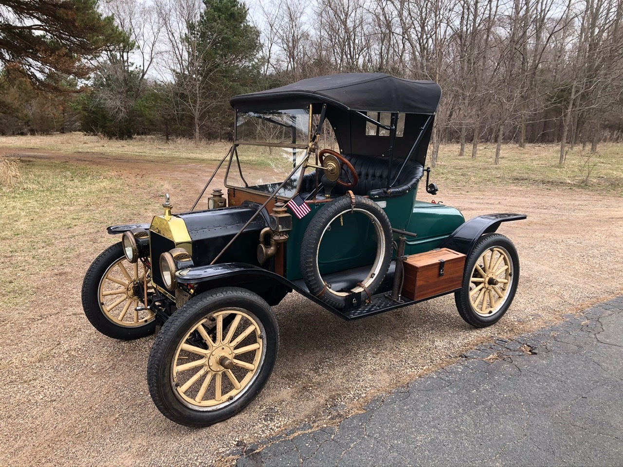

Here is my 1913 (correct chassis with newer wheels and a 1914 windscreen) mated to a 1917 body back in 1953. A very FUN car to drive. I really don’t give a darn about what the experts think.

Snazzy car, Jeff
looks like fun
