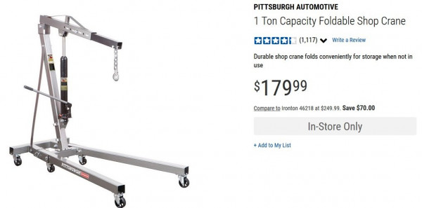

Post by TRDxB2 » Tue May 19, 2020 8:59 pm
Russ, you triggered my brain cells putting 0 + 1 to come up with Pittsburgh as in Harbor Freight -- https://www..com/1-ton-capacity-foldable-shop-crane-61858.html

This worked for me twice. The legs on a Pittsburgh engine hoist will go under the front axle.

Most engine hoists that are being talked about on this post have an extendable arm so the length shouldn’t be an issue. The one shown in the pic is almost identical to the Harbour freight version I bought a while back and probably made at the same place as others in this price range.

Post by dhosh » Tue May 19, 2020 10:02 pm
Very good,call... I think my friend's looks exactly like the one in TRDxb2 (?)'s post. It's arm is extended all the way... It just seemed short. I don't have the poster's name, but will check it's horizontal reach tomorrow.
By the sounds of everybody... Looks like it should work fine!

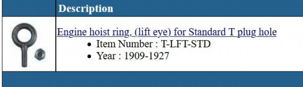

The arm length is OK or adjust to your preference. The two legs roll up under the car so you can get directly over the engine and you can use a short chain with a hook to go through the eye bolt that’s screwed into the next to last spark plug hole. I think that’s where I screwed the eyebolt into on my last engine pull.
In my case I rolled the car backwards and lowered the engine. It just depends on your set up which way you do it.

Yes... I've used them before... His arm was extended all the way out, but appeared too short... And I was there today, and forgot to measure it! Maybe tomorrow

That picker will work - I have the same and have removed & installed dozens of T power plants with it.
