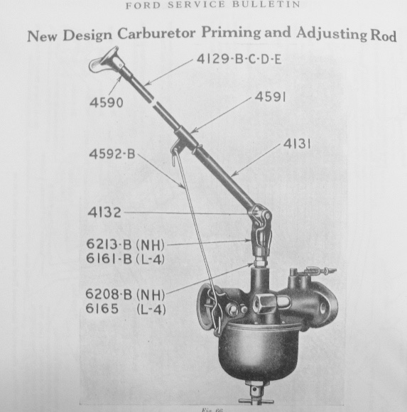

Our 21 touring has a Holley NH swivel top carburetor. The carb is in good shape, but since the swivel top was originally for 1925-26 cars with taller firewalls, the adjusting rod makes too large of an angle at the U-joint to go through the shorter 21 firewall, making it very difficult to adjust the mixture while in the car.
Does anyone know if I can convert the carb to a nonswivel version by removing the current swivel spray needle and clamp nut and replacing them with these from Langs?
Adjusting needle clamp nut for Holley NH:
https://www.modeltford.com/item/6208.aspx
NH Spray needle assembly:
https://www.modeltford.com/item/6213.aspx
Thanks,
Neal
Thanks,
Neal

Re: Converting Holley NH swivel top to nonswivel NH?
Do it! An NH will accept either.
- Posts: 5552
Not necessarily, the threads for the spray needle are in the nut for the 25 up NH's. Your carb body may not have threads in it for the earlier spray needle. Check.

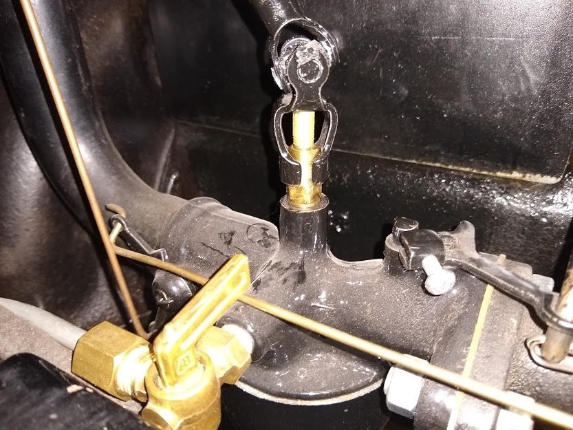

Here's a picture of the top of my NH carb. The clamp nut threads into the carb body like the nut for nonswivel top. Is this what you were talking about?

- Posts: 5552
Pull the spray needle and nut to see. The earlier carb clamp nut does not have threads in it like the later one you have. The threads the spray needle screw into in the earlier carbs are in the carb itself, not the nut. Your carb body may have the threads, that is why I said to take a look see.

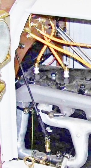

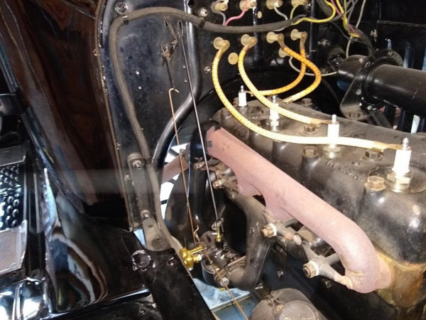

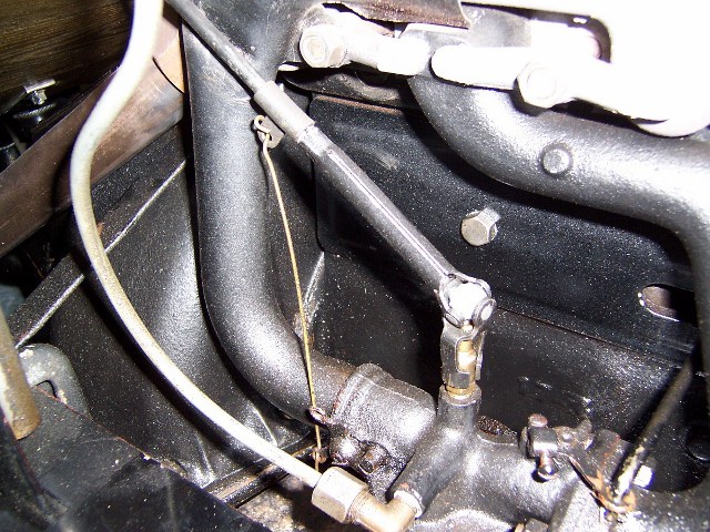

I appreciate the feedback. I may just leave it alone, but I do have a question about the actual installation as it came on the car when I bought it. The picture shows U joint at the top of the carb, but then there's a second U joint to get the adjusting rod around the intake heat pipe, where the rod then goes up to the hole in the metal firewall.
All that zig zagging is what makes it hard to turn from inside the car. Is that how the installation is on a 25-27 car, or is this someone's attempt to make it work on this car?
Thanks,
Neal
Thanks,
Neal

Rube Goldgerg attempt ! If you are going to utilize the swivel type adjuster, one needs to also use the later style hot air pipe that has a flattened area for the adjustment rod to clear.
- Posts: 5599

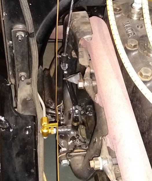

I also see that you stated a '21 BUT it has been updated to a steel firewall - original would have been wood - it sure appears as though the adjuster rod is not coming out of the correct slot for proper alignment !

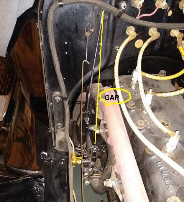

Your actual problem is two-fold:
1. the carb stove (heat pipe) is not snuggled up against the exhaust manifold; it is sticking far too far off of it.
2. the kludged double-universal is made to go around it and will never work properly
with the carb stove properly positioned, the correct adjuster sans-swivel will JUST go past the stove (or maybe rub on it, mox nix).
You need to buy:
1. proper needle
2. proper adjuster rod
3. proper needle clamp nut
problem solved and life is good

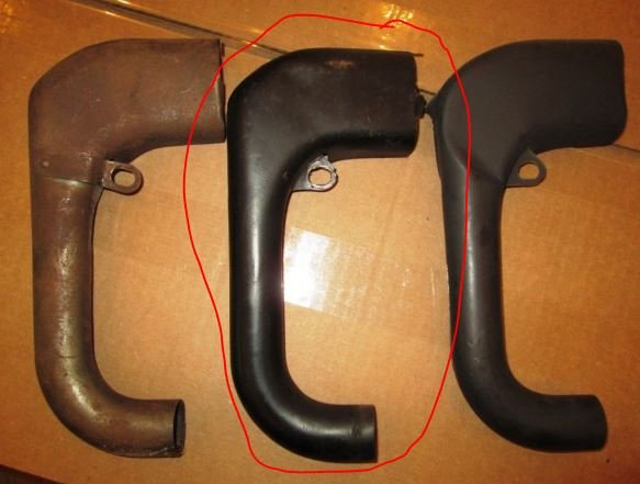

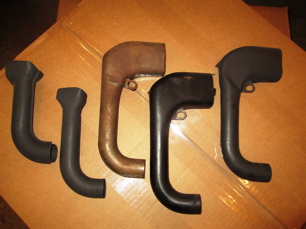

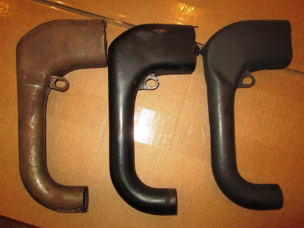

Here's a quick hot air pipe 101 - I'm not the encyclopedia so let's remember that - far left is around 1912 + /note the crimped edges, next is '13 to later teens, 3rd is into the later teens w/old style clamps, 4th is new style clamps (mounted in reverse of original) - note mount and last is new style clamp AND swivel adjuster - just my own observation. I have close-ups if any interest.

I'll add one more thing to my post, and that is that I suspect that your hot air pipe is a reproduction. Every reproduction pipe should come equipped with a set of tin-snips, because it needs it. Without significant massaging with tin-snips, every reproduction hot air pipe fits exactly like yours does right now.
- Posts: 5599
Astute observation on Scott's part & to add to Scott's post - all repros I've seen have an open mounting point - originals were closed like shown below on the left.
NealW
Topic author - Posts: 523
- First Name: Neal
- Last Name: Willford
- Location: Kansas
Steve,Astute observation on Scott's part & to add to Scott's post - all repros I've seen have an open mounting point - originals were closed like shown below on the left.
The heat pipe on our 21 is the circled one in the picture below. It does not have an opening, so perhaps is original make from years ago. The unknown installer or restorer apparently decided to add a second U joint to get around it. Regarding the steel firewall, they were available in 1923? and were backwards compatible for post 1916 cars. I'm glad that the car has one, as it seems more durable than a plywood one.
Scott is correct that the holes in the repro ones, at least the one that I installed on our 15 restoration, needed reworking to get the hole opened enough some to allow the clamp to fit correctly.
I may just order a new heat pipe with a hole when I get a needle, clamp nut and new rod and at least make it correct for the year. Having it work better would be nice too!

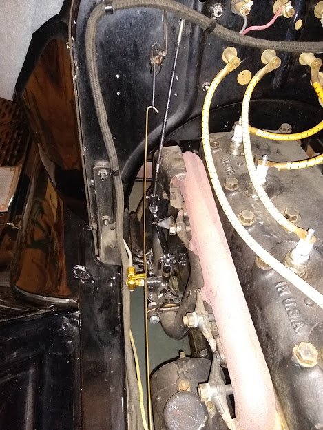

My new heat pipe, mixture rod, nonswivel needle and nut came in the mail today, so time to swap out the parts. As expected, I needed to do some filing on the hole in the heat pipe to get the exhaust clamp to fit. I also needed to slot the hole in my firewall a bit more to get the triangle shaped end of the rod to fit through.
One thing that surprised me a bit was how much my mixture setting changed. I initially set the needle to about the same as the one I removed, but I had a hard time starting it and keeping it running well. It was too lean, requiring about 1/4 more turn rich for it to idle and run well. The shape of the needle was apparently different.
Anyway, I can now finally adjust the mixture from inside of the car, and the car is now set up correctly for its year.

Congratulations, Neal. Job well done.
I sure wish the repro adjusting rods were made correctly with the correct size handle, don't you?
In retrospect, isn't it pretty funny all the trouble the last guy went to to solve that problem?
