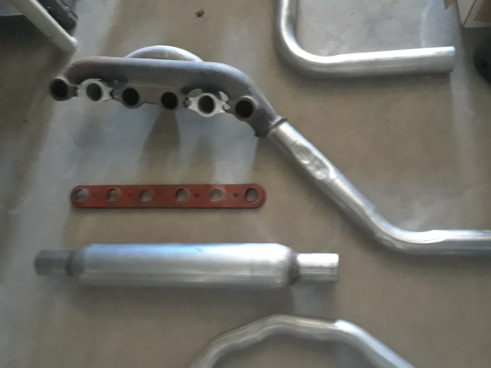

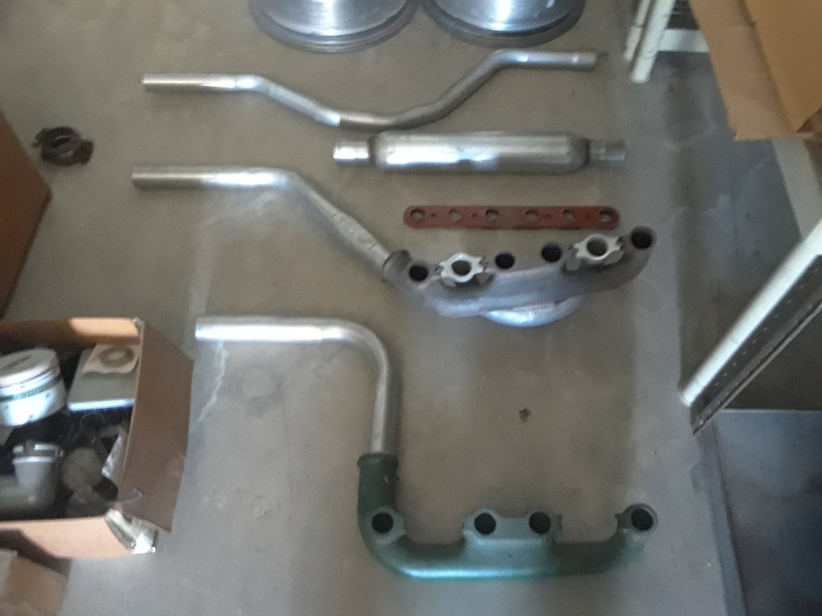

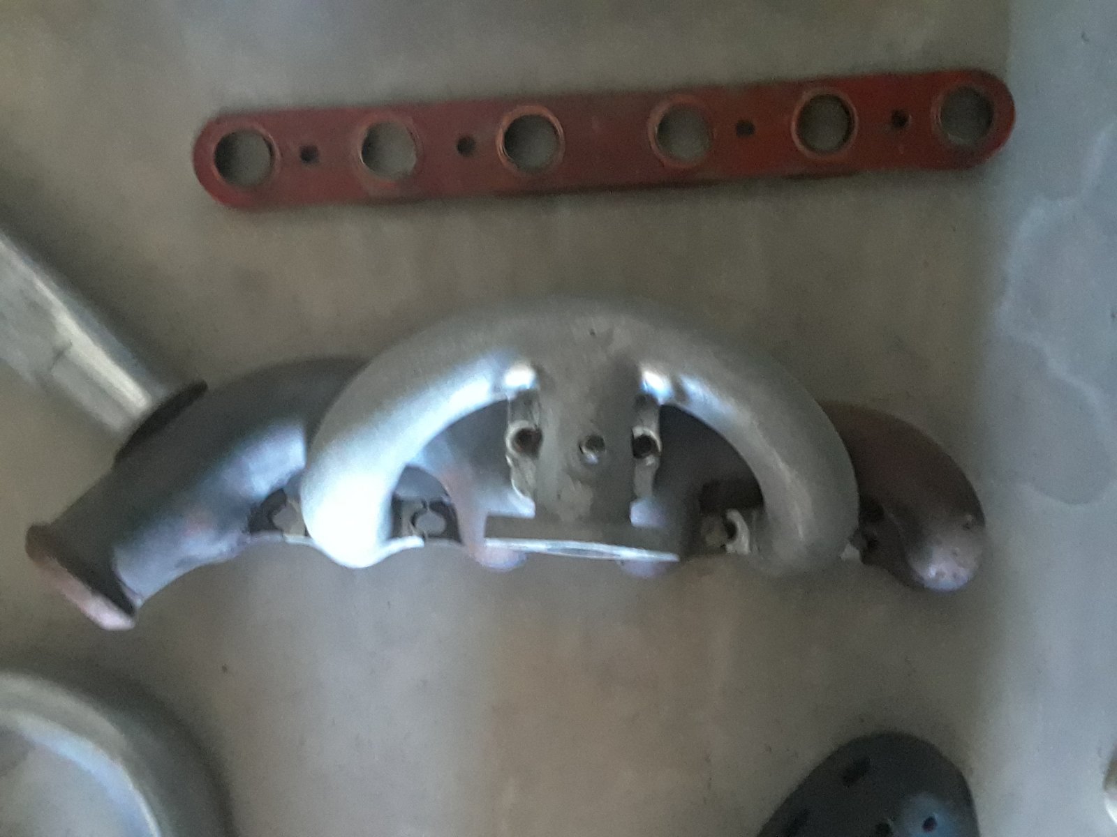

There have been many reports that the Walbow lawn mower carbs do not run or perform well without a fuel pump. A straight through NH or a Simmons or Wizard straight through would be the easiest and most authentic. A Zenith updraft carb on a Winfield manifold also appear to be popular, though they require linkage modification. I had a 4 door sedan with a warmed up engine similar to yours and had a Model B exhaust manifold and aluminum intake manifold with a Stan Howe rebuilt Stromberg OE-1 updraft carb. I removed the setup and returned it to stock before selling it, so I still have the setup.
Pictured with the aluminum intake is the Model B exhaust manifold with its 45 degree outlet, but I have a regular Model a manifold with the 90 degree down outlet, also. I, also, have the complete exhaust from manifold to tail pipe.
