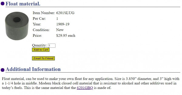

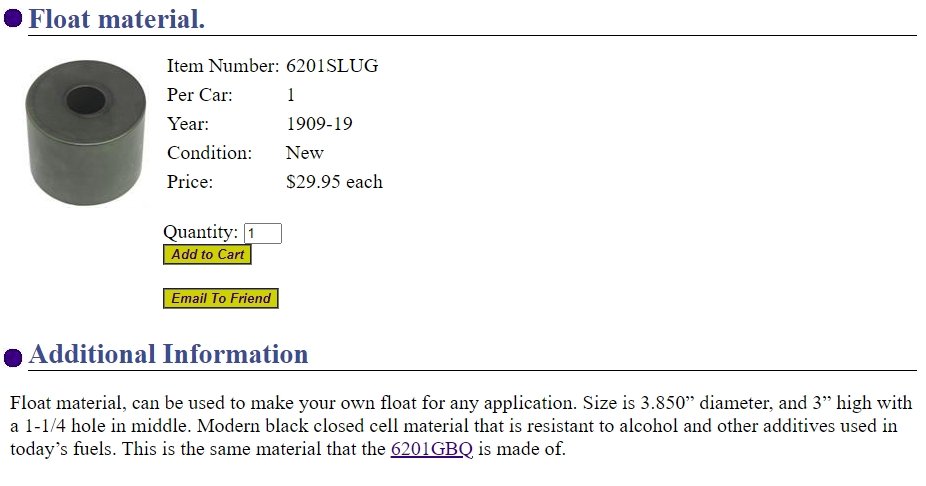

I suggest you just get some modern float plalstic , make a float and be done with it!
This is from Langs, I assume most vendors have it.
TH
TH

Good idea Terry.... I hope that’s the plastic float material that Stan will be using on my two
U& Js..
U& Js..
