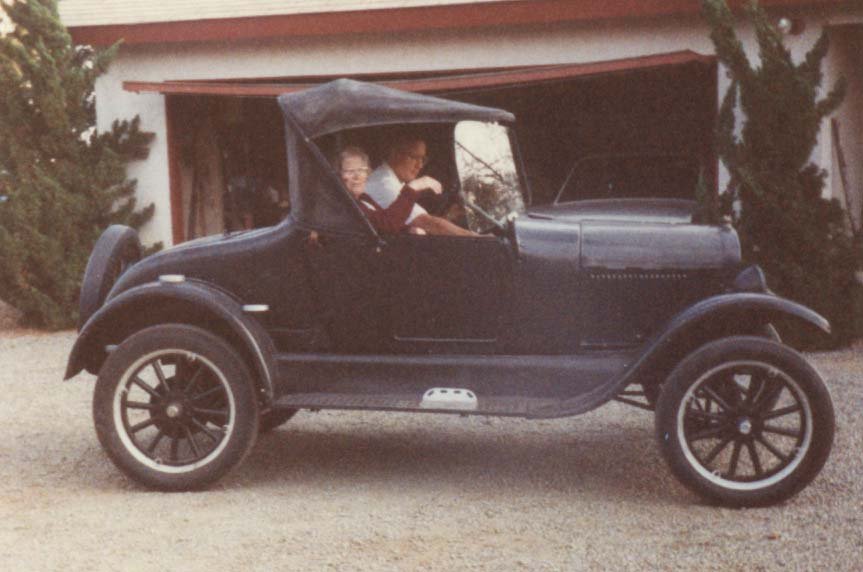

Does anyone know if a 1925 Roadster Top will fit a 1926 Roadster? I am looking at a 1925 top but I have a 1926
Posts: 4634
Re: 1925 Roadster top fit 1926 Roadster?
Post by Norman Kling » Fri May 29, 2020 8:51 pm
The bows will fit, but you will need to trim the top material to fit. However it does not look correct because the 26 bows are curved and place the back of the top further back than the 25 top. Mine has a 25 top bows, but when I put the new top on the car, I didn't realize I had the wrong bows.

Thanks. Does the top still fold back correctly?

yes It will fold down.
