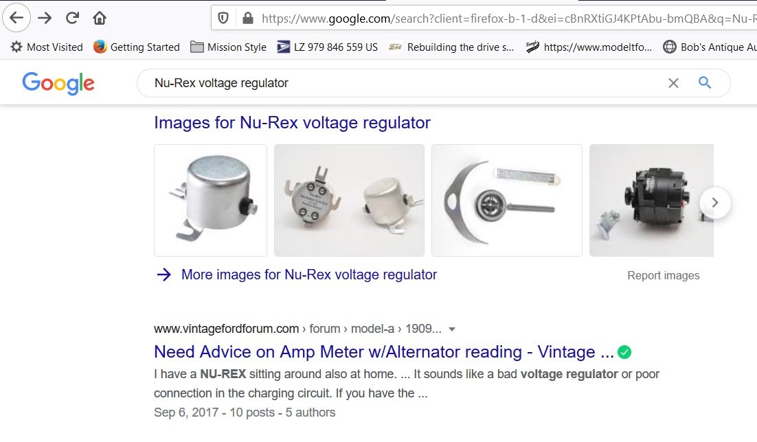

The Nu-Rex Generator Cut Out (Semi-Conductor Type) js NOT a voltage regulator. It does not "put out" up to 20A; I believe it is just a Diode cut out capable of passing up to 20A of current through it which is apparently the same current ratings as the original cut out contacts. The FP VR is a completely different product with much improved functionality.
- Posts: 6588
Re: Fun Projects VR
You are correct it is just a cutout I got GOOGLED bad. Like so many search engines they provide unwanted alternatives mixed in with what you asked for. I should have caught it. Sorry for the misinformation FrankMKossor wrote: ↑Fri May 29, 2020 6:54 amThe Nu-Rex Generator Cut Out (Semi-Conductor Type) js NOT a voltage regulator. It does not "put out" up to 20A; I believe it is just a Diode cut out capable of passing up to 20A of current through it which is apparently the same current ratings as the original cut out contacts. The FP VR is a completely different product with much improved functionality.
