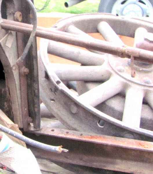

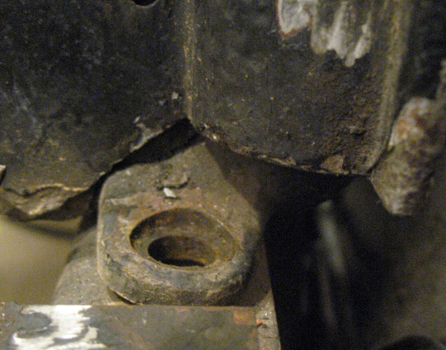

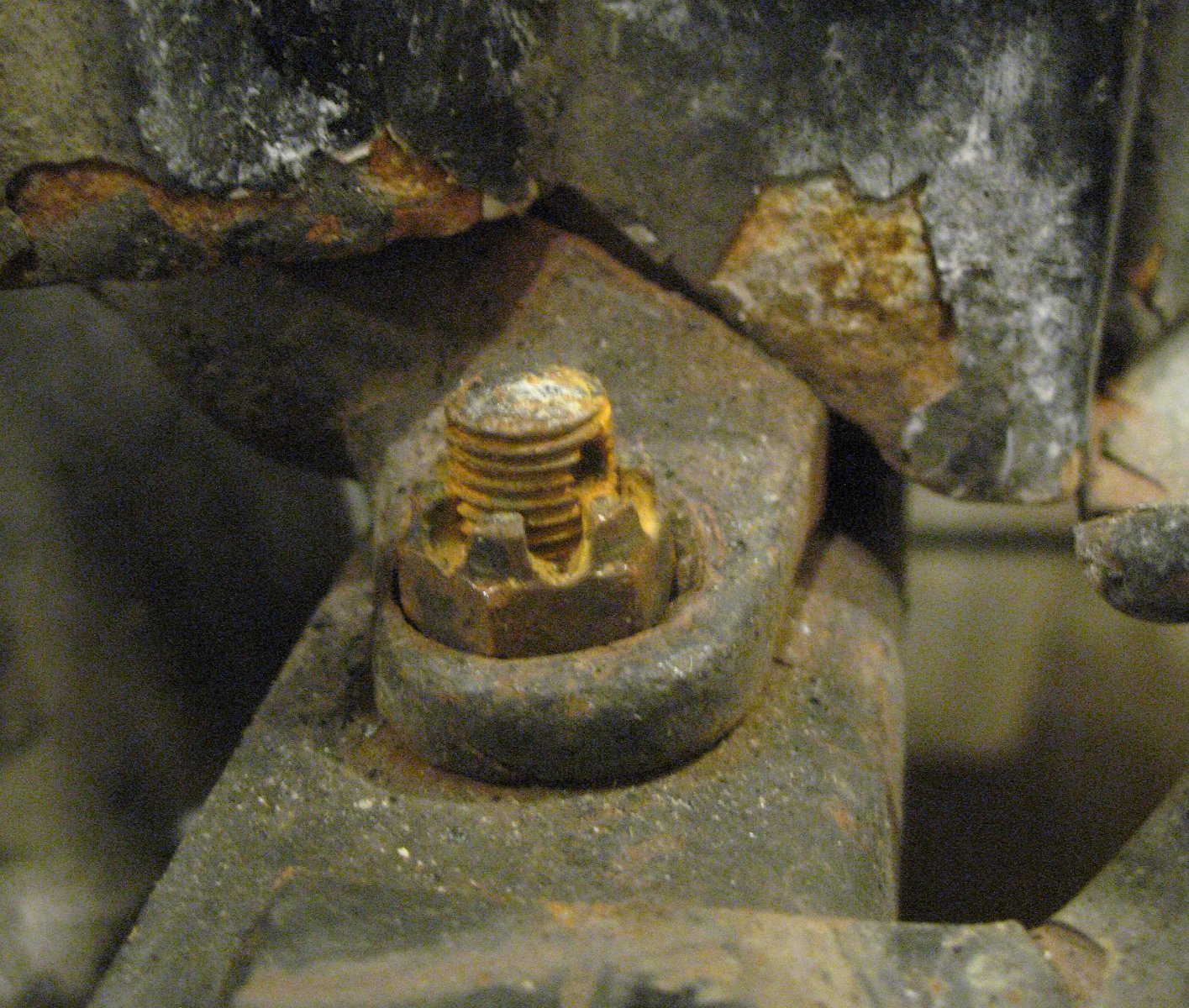

Post by Steve Jelf » Tue Jun 09, 2020 11:01 pm
What goes here?
I suspect a nut sitting down in a recess where you have trouble getting a wrench on it may not be correct.

Post by Allan » Wed Jun 10, 2020 6:14 am
Steve, my recollection is the nuts do go on top as you show. I could be wrong. If the depth of the machining around the hole is a concern, put a spring washer under the nut. You have plenty of length to still be able to insert a split pin.

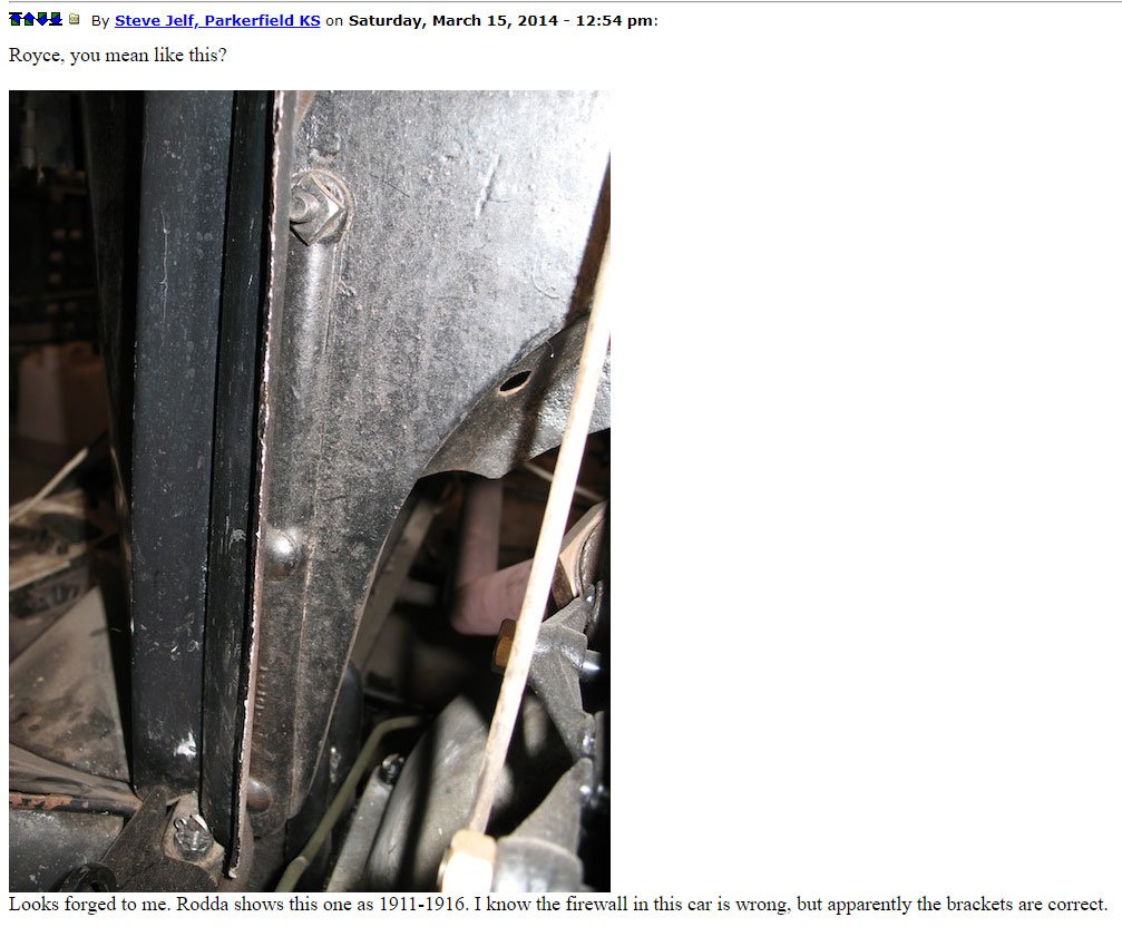

Post by Rich Eagle » Wed Jun 10, 2020 4:45 pm
I have always done it that way with the nut topside. I don't know why. If it wasn't right someone would have called you on it back here:
http://www.mtfca.com/discus/messages/41 ... 1394896234

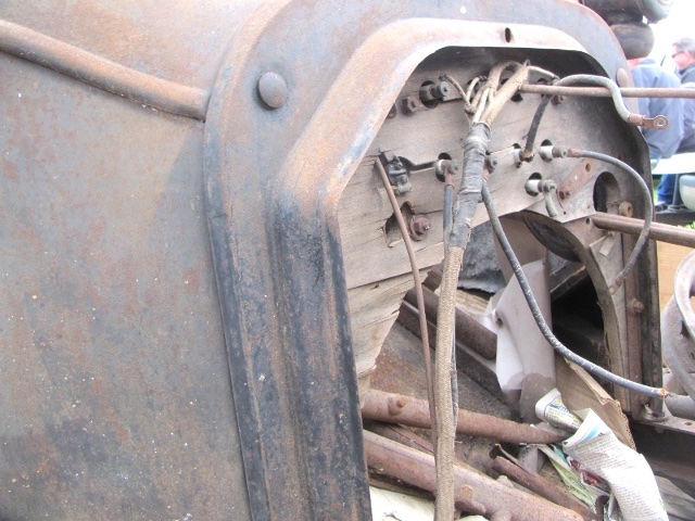

Post by DanTreace » Wed Jun 10, 2020 6:33 pm
This very original '15 body was at Chickasha a few years ago...
Sure seems that the nut is under the frame, as there would be interference with the hood former if the castle nut was above.

Note how Steve's original bracket is spot faced at the bolt hole so that the bolt head sits flat. The current reproduction brackets that I have seen don't have the spot facing. :)
