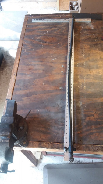

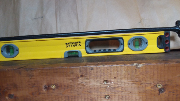

Post by blgitn » Sat Jun 13, 2020 7:17 am
Here are the parts I took off:
The drag link is a little wavy but the tire \rod is really curved! I found a straight tie rod in the pile and I'm putting the better end and ball on it. I found a better drag link too, but it's not perfect so I think I'll reinforce it anyway. Spruce-and-cord would be cool, but a small angle iron is easier to source. What have you guys used?
R/ Roger.

Don't overdue reinforcing things. Strengthening one thing and other thing bends or a causes excessive wear to other components. Consider the affect on the entire system, steering shaft to spindles
Posts: 6820
Re: Drag link flex
Post by Scott_Conger » Sat Jun 13, 2020 12:48 pm
That much bow, and it sure will flex. Straighten it and it will not flex. Simple as that.

I made a new rod for my '14 from solid. It's a mite heavy but it's straight and strong, and I don't have to worry about its being weakened by unseen rust from the inside out.
