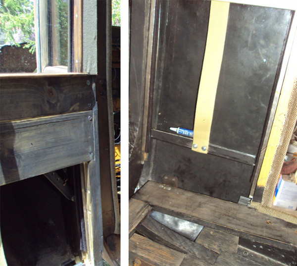

I am in the process of putting window channel felt in my 1923 T coupe . I need to know does the window felt go all the way to the bottom of the window channel , or just the top half of the closed area.Iput a piece in the channel area but the channel area is curved, and will not allow the window to travel to the stored area.Any help is appreciated.

It should go all the way to the bottom. This shows my '22 but is about the same.
