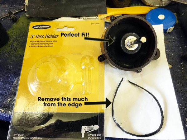

Anyone with a New Day timer knows the value of cleaning the interior contacts from time to time. Previous posters have described devices made from plywood and the like. I'd like to suggest an additional possibility.
I purchased a 3 inch sanding disc holder from Harbor Freight. By cutting off a tiny bit around the edge it is a perfect fit for the timer. Glue a piece of sandpaper to it and you have your "re-conditioner." Just lightly clean the contacts with the device chucked in a drill, blow it clean and you're in business.

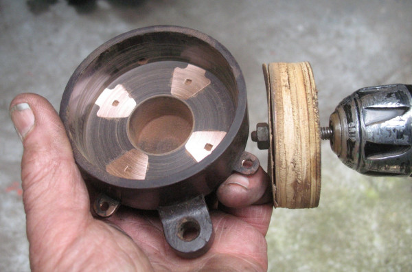

Post by Steve Jelf » Wed Jun 17, 2020 3:34 pm
Mister Thrifty uses a thick chunk cut from a wood scrap with a hole saw to fit. Being thick it wont cut into the sides of the timer case. The price is perfect. :)
