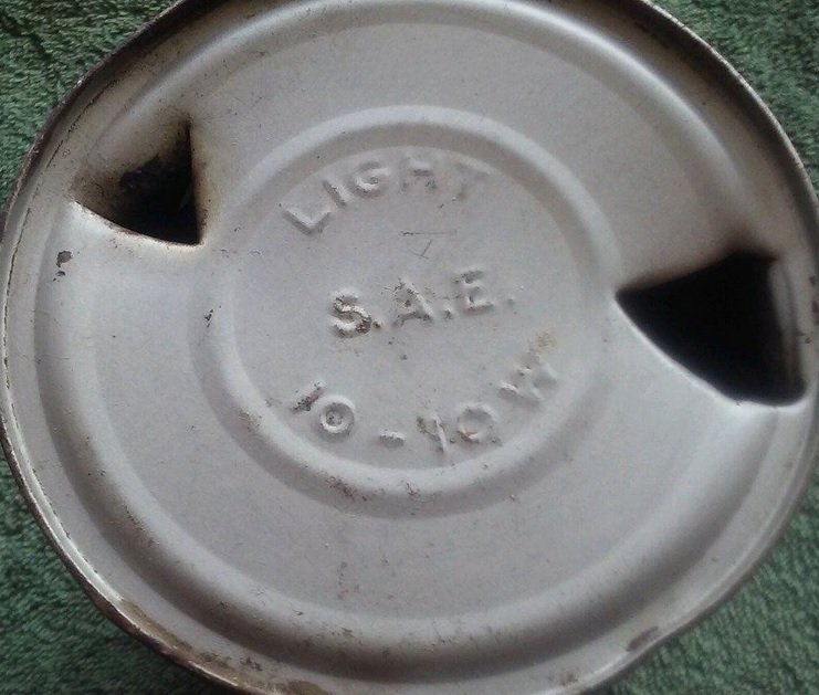

Squirrel
- Posts: 140
- Joined: Sat May 30, 2020 9:54 pm
- First Name: Jim
- Last Name: Forbes
- Location: Sierra Vista AZ
Re: Oil weight
Pictures of old oil cans. Draw your own conclusions.
