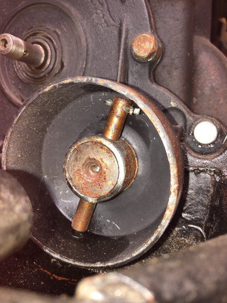

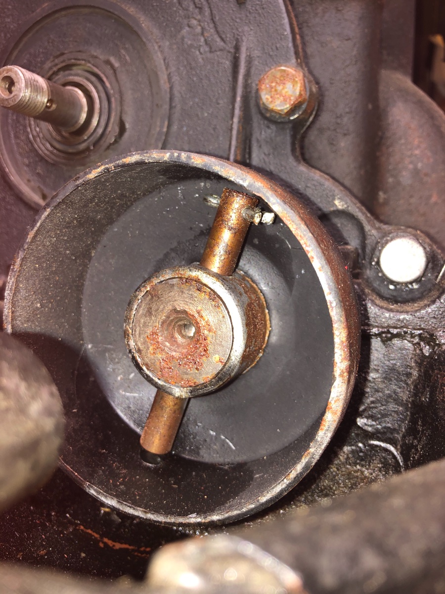

Remember to drill the cotter pin hole near one end. That pulley pin or starting pin as Ford named it, needs to be retained, if it should drift it can rub the fan belt. So a tight pin is the right pin.
Install the pin with cotter hole end up, into that larger hole of the crank pulley. That smaller hole in the flange of the crank pulley is for starting a drift punch to drive the pin out the bigger hole. That cotter keeps the pin out of the opening, should the starting pin ever migrate.
Use a good steel, as that solid pin takes the load of the crank handle ratchet when turning over the motor, it does need to be real strong.

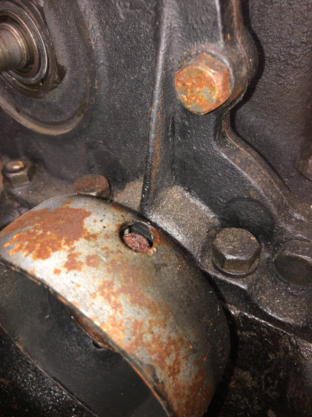

I have a follow up question. Once the pin is out is there an easy way to get the pulley off the shaft with the engine in the car? Specialty tool? Any one know the model/make of a puller that will fit nicely? I have a 15 touring with the narrow pan and my pulley appears to be wobbling and it throws the belt with great regularity. It does not feel loose on the shaft but has already been drilled once at 90 degrees to refit it so I believe its time to replace it. I purchased a new split pulley that can be squeezed down to fit the shaft in case it's worn but not sure how best to go about getting the old one off. Remove radiator and hand crank, dive pin out, and then??
