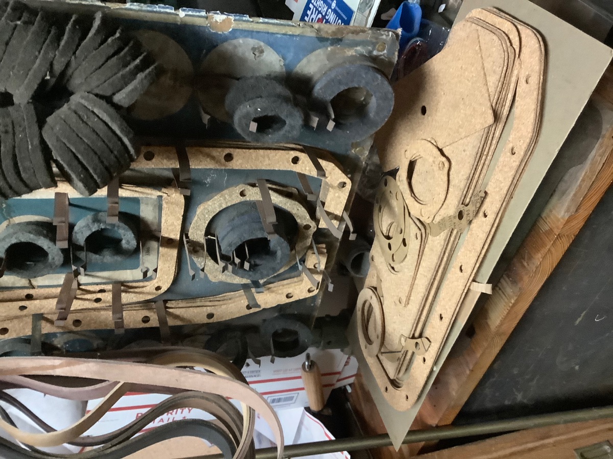

Are you wanting a specific gasket in cork, or a set Dan ? I think Mr Morsher cleaned me out.
Dropacent
- Posts: 3384
- Last Name: Morsher
- Location: Norwalk Ohio
Yup !Cork Gaskets
Yup! Dave’s got a memory like a steel trap

Looking for gaskets for the Transmission Cover and Inspection Plate, also the Starter and Bendix Cover.
