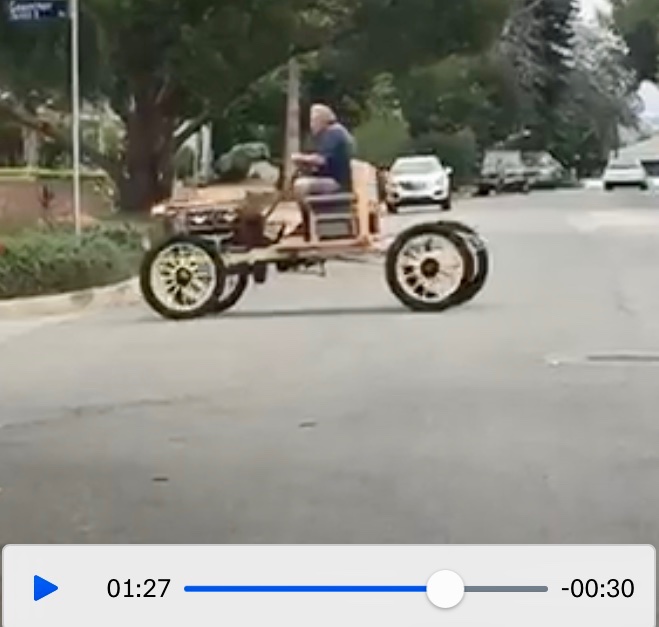

Kim sent this video of his successful test drive of this early production (#51) Model B. Click on the link below to view his drive:

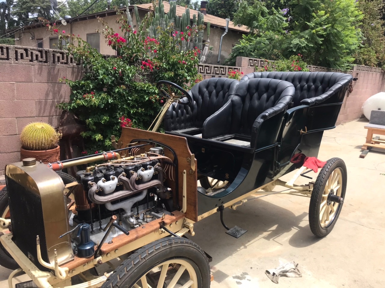

Thanks Rob, that's the first time model B #51 has been on the road in a very long time. The cars owner asked me about 2 years ago if I'd get the car running . I thought it would be a 2-3 month project. Well 18 months later it's on the road. Everything had to be gone through, radiator to rear end. I took the radiator down to the shop I normally use to get a few leaks repaired. The owner called me the next day and said it's junk and I need a new radiator. I went down and met with him told him there is no new radiator and this one must be fixed. When I picked it up, he said he did the best he could and it doesn't leak a drop. The water pump had to be remade and new pump gears cut. My friend Don Skille did a nice job on it. All the engine and cam bearings were very loose and need lots of filing and shimming. The valves were pretty good, I got away with just lapping them in. The aluminum intake was cracked and broken, all the water fittings had to be remade and new tubing bent. The distributor had to be rebuilt and a new exhaust pipe bent. R. V. Anderson did a real nice job on the coil box. The transmission was the biggest challenge. Many of the parts were badly worn and other parts were incorrect. There are only 6 of these cars in existence and all of the old timers who restored or rebuilt them have passed on. So there isn't much collective knowledge out there about these cars. I got lucky and found all the transmission drawings for the model B at the Bensen research center in greenfield village. Glen Rand made me new clutch discs and Robert Sinsly made me a new clutch ball and fingers. Ray Wells rebuilt and painted the body which I'll be putting on the chassis today. After fender and top installation. Freighter Jim will be taking the B back home to Oregon. It's been a great experience working on a car so rare old obscure. I'm hoping to get it to the old car festival in Detroit so more people can see this great car.

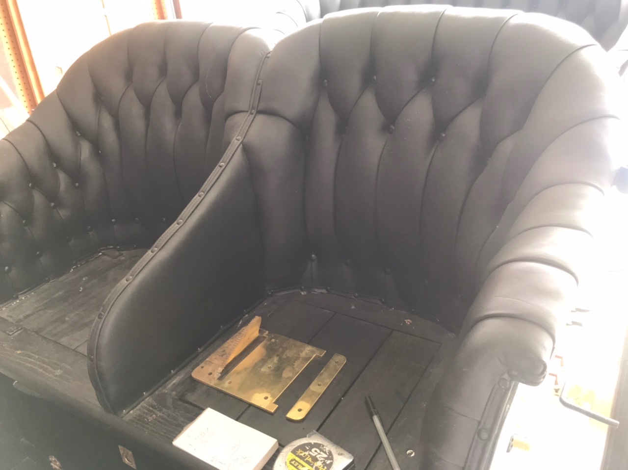

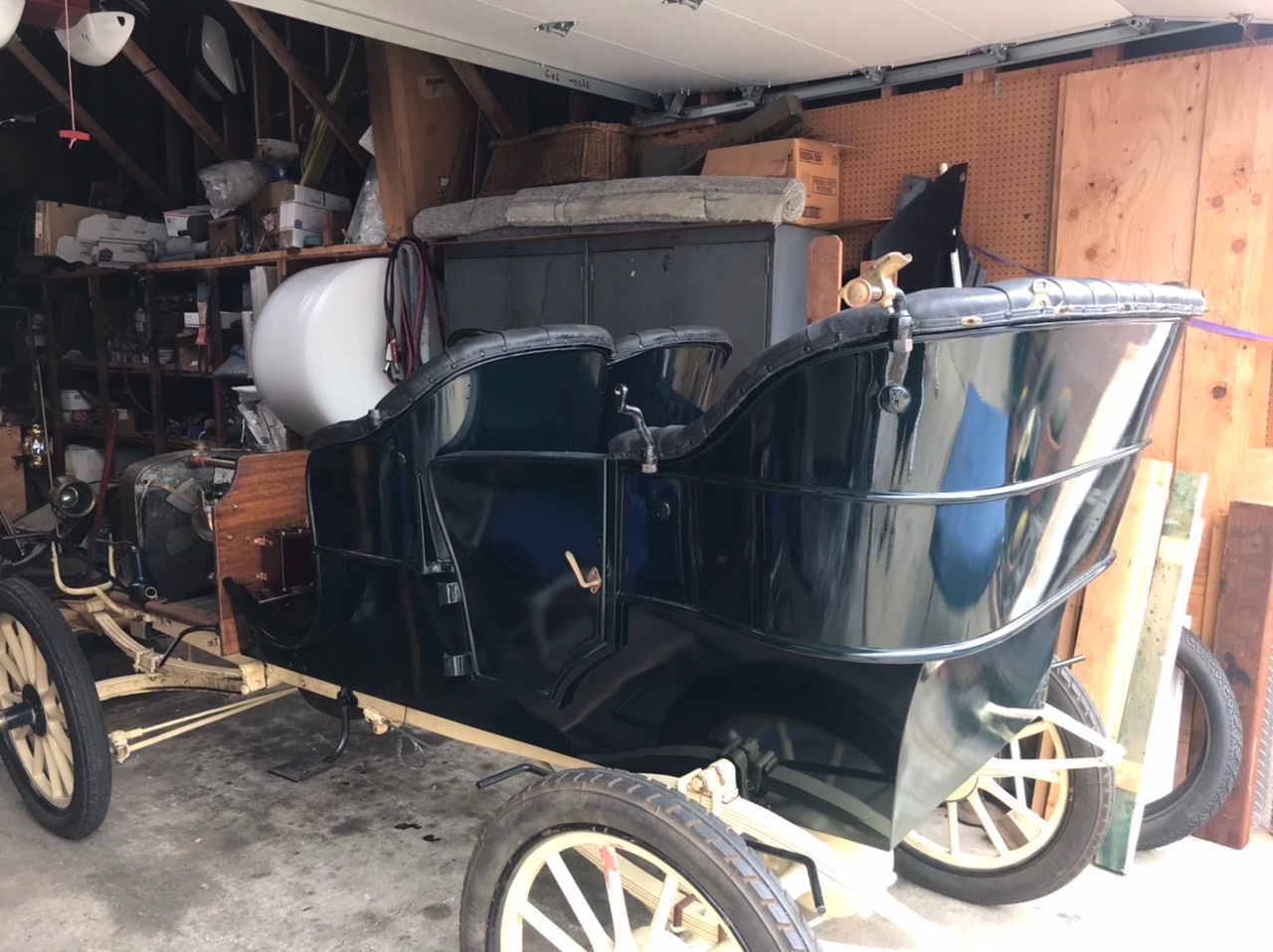

We put the body back on yesterday. It sure is heavy. There were six of us!

Pics of body on chassis.
