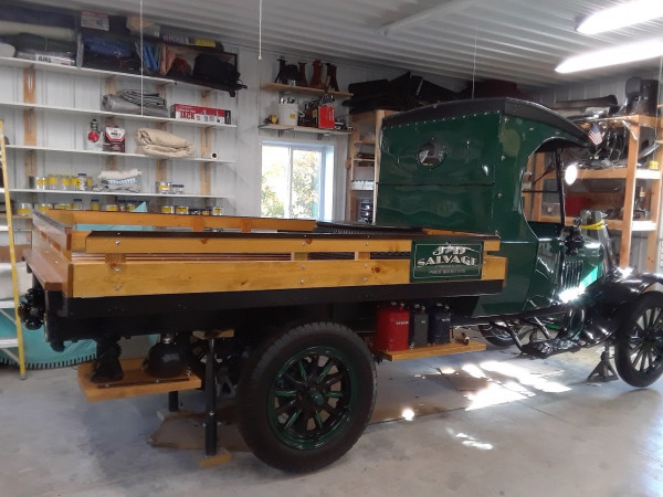

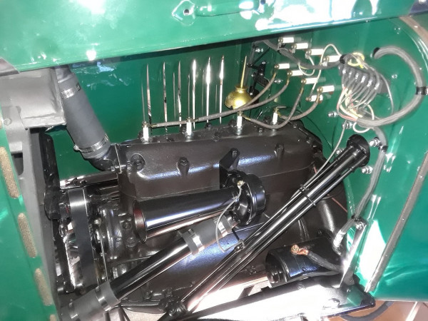

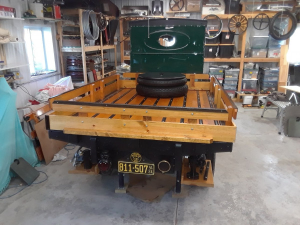

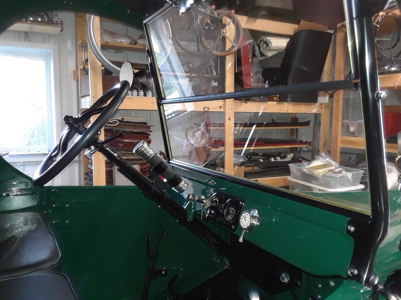

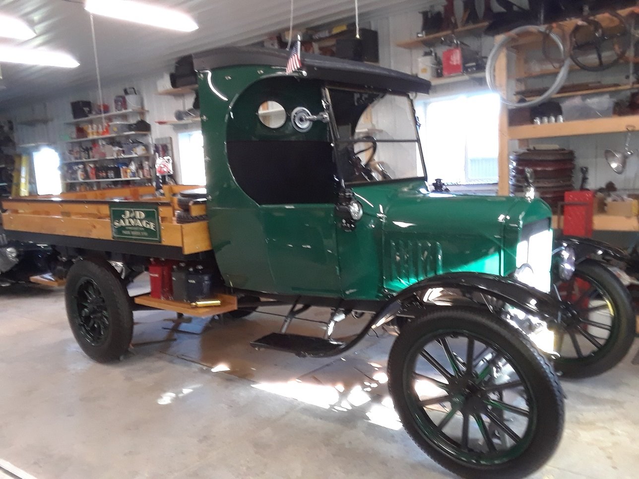

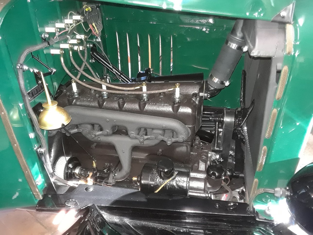

My non Ruckstell '24 TT C Cab would not pick up speed after shifting into high gear. At full throttle in high gear, it would go very much slower than a crawl when compared to a standard high gear speed when the road is flat and even. When there is a slope on the road, with the TT in high gear, it was unable to move forward until a shift to low gear was made. Reverse and low gears have normal and prompt responses.
The previous owner told me that the engine, trans and drive line were rebuilt. I trusted that information and proceeded to completely restore, refurbish and replace all sheet metal and other components as necessary. These were completed a couple of months ago. The weather was good recently and a shakedown run was made and the high speed dilemma was experienced.
I've had T's since 1982 but am not an expert by any means. I have always relied on the advice from other T enthusiasts and from the T manual. I have two TT's with the first having a fully rebuilt engine, transmission and rear end that I contracted to a professional. When comparing the two TT's, their operational characteristics and engine sounds are very similar, almost equal, except for the high gear condition on the second TT.
I suspected that the problem was due to a clutch adjustment. Before I proceeded to tighten the clutch fingers and adjust the low speed connector clevis and lever screw, I thought to post my dilemma into the Forum with the hope of affirming my prognosis and to also garner additional advice.
Attached are pictures of the TT C Cab. Not a complete OEM factory replica but reconstructed to suit my personal choices and preferences. Just having fun.
I appreciate all comments and advice. It is a way for me to learn more.
