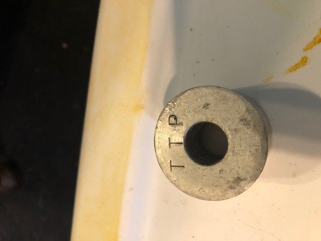

I received these in a box from my brother-in-law.
Not sure what they are.
Thank you
What are these?

Re: What are these?
Parts to a front end/axle alignment tool. Maybe.
- Posts: 6796
- MTFCA Number: 1219
Re: What are these?
The TTP is a centering tool for aligning the front cover on the camshaft end for the commutator. The rods might be push-rods for an overhead valve set-up if they are about that size. Hard to tell size from photos.

Re: What are these?
Adjustable pushrods, wonder if the other 6 are around...
And the cover tool. Nice.

Re: What are these?
Would the "TTP" stand for "Texas T Parts"?
