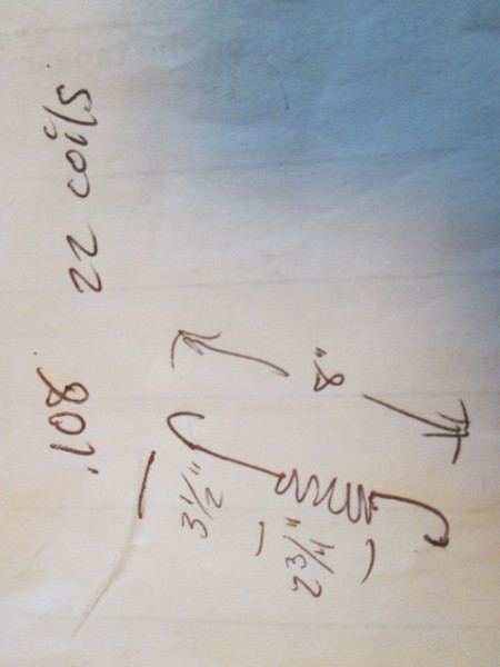

My spring measures 8" long total, made of two straight pieces with round bends at each end. The coiled part (22 coils) is 2.75". The spring steel is .108"D. The top part (straight with a hook) is 3.5" long. The hooks are face opposite directions. Attached is a sketch.
Phil

Post by George Hand » Wed Jul 01, 2020 5:01 pm
Philip Jamison, Thank you for looking at your machine & giving me the information on what size that spring should be. Now I am on a spring hunt, it works fine but I feel it would be easier with out the lever flopping around. Thanks again George
