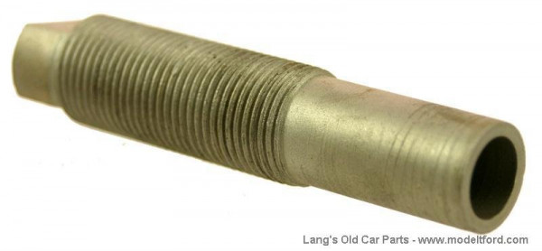

Courtesy of Lang's Old Car Parts pictures, your adjustment screw on right side of the hog's head should look like this:

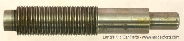

And what you want, looks like this:
Here is the link to buy what you need: https://www.modeltford.com/item/3419B.aspx
Once you're holding the new shaft in your hand, you can use THAT part to see how short to cut the pedal shaft to have the same amount of "stick out" to capture the band and spring.

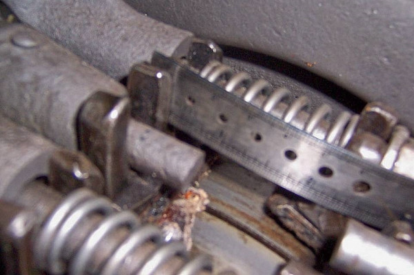

Richard
The Service Manual at paragraph #543 says to leave about 7/8" of an inch of the long low pedal shaft, at the shoulder.
There is little difference of bands, other that the demountable ones have the left side lug that is removable.
Since the earlier low pedal shaft runs all the way across both lugs, into the p/n3419 hollow adj. screw, there is no way to pull out the removable lug as it is still captured by the long low pedal shaft.
Cut off the low pedal shaft, and then use the new p/n3419B 'stubby' adj. screw that only reaches to the right hand lug. The left hand removable lug will ride on the now cut off low pedal shaft, with the band spring between the stub ends.
Bold type for your eyes :), you're welcome.

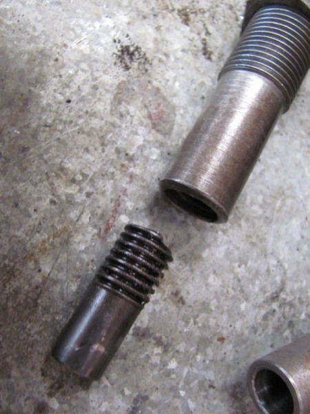

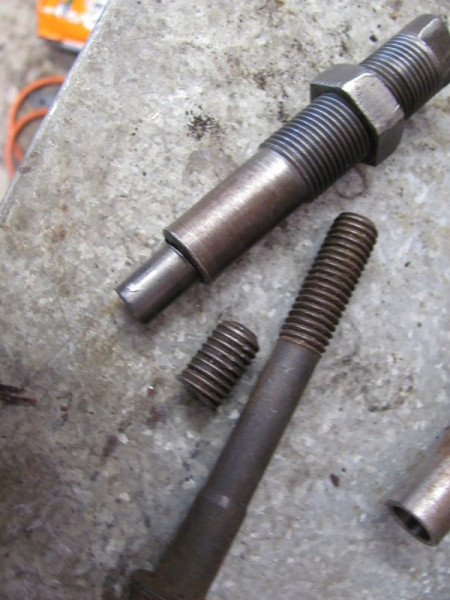

And, if you don't have the new style stubby adj. screw, one can be made by threading an earlier hollow 3419, and placing a cut off threaded shank of a bolt, threaded into with LocTite, so that hollow screw becomes a stubby screw.
