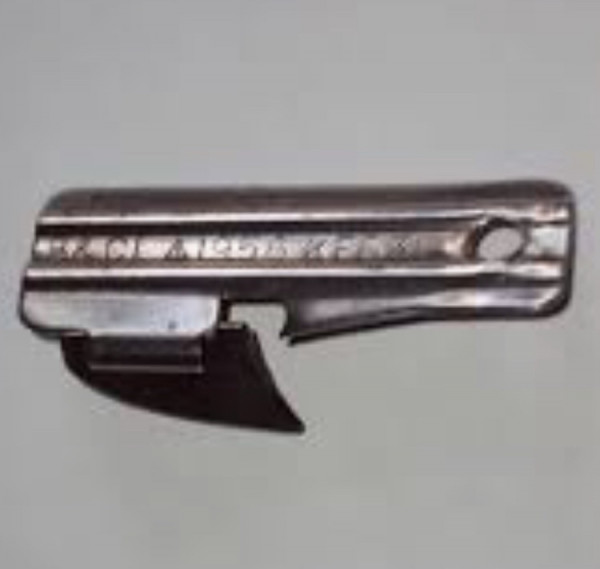

If you’re trying to be authentic...

Kevin, how can a can opener dated 1956 be authentic for any T model? :D

Sorry Allan... was the oldest one I could find a picture of...😔

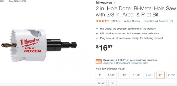

You'll find a hole saw is the way, neater than a can opener ;)
Here is an old time original, with bit and brace to cut....work out.
I have one like this that was my Dad's from the 50's. Works great and has all its cutters too for different diameters.
Or get a single size cutter for your speedometer o.d.

Using a hole saw for the size you need will work fine or a Greenlee hole punch will work also.
It’s a metal dash and the 2 items mentioned above are used for cutting holes in metal doors, electrical panels, boxes and etc.
if you have a Grainger industrial supply close to you they have everything you need. They also have an online catalog you can check out. I worked as a maintenance mechanic before I retired and used both in all kinds of metal panels and etc.
They will definitely work.

I stand corrected... turns out the P-38 can opener wasn’t invented till 1942. So NOT a period correct holemaking method. Guess you’re goin to have to look for an ‘ol bit and brace... or get out the ‘ol trusty cold chisel!! :twisted: :lol:

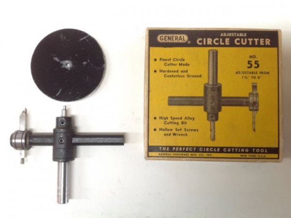

Lacking the proper sized hole saw, I used this Adjustable Circle Cutter I had on hand.
