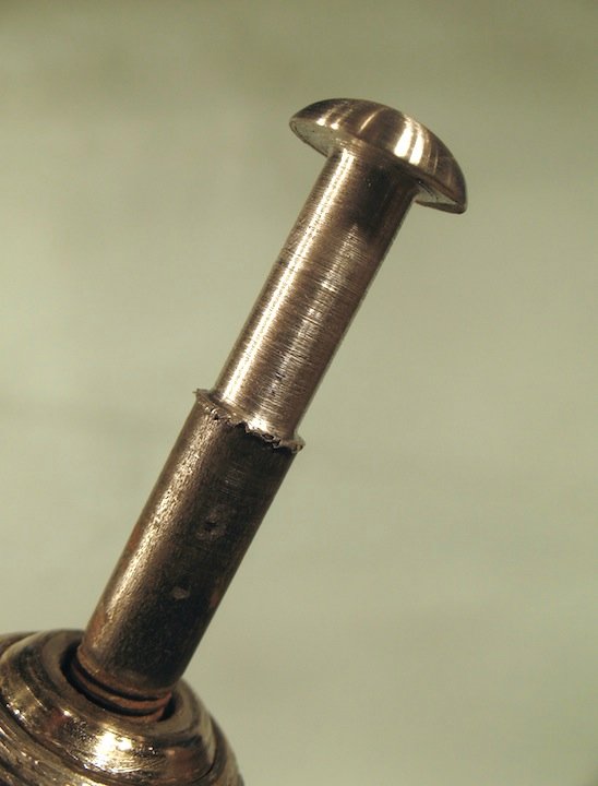

Many of the rivets used on a Model T are available from Jim Dix (Big Flats Rivet Co.). You can Google it. Some are easy, others not so much. I finally gave up trying to find a correct top iron rivet and made one myself from a bolt.
