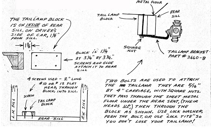

Looking at Cubels body wood drawing it looks like that rear wood is only an inch or so wide. My '14 is like that but uses a 2 hole bracket. I wonder if they screwed a short piece in there for the third hole on a '15 that is missing on yours.
I hope someone who knows will respond.
Re: Help!! Taillight bracket failure - Something doesn't seem right...
Post by Rich Eagle » Sat Jul 11, 2020 10:43 am
This sketch was in with my 1914 stuff and shows a block as I was imagining it. Perhaps a similar block was used for the 3-hole bracket in '15

Yes, it's a touring.And that block would make sense - I wonder if, when dad had the car painted decades ago, someone forgot to put the block (or L bracket or whatever) back? Hmmm... I'll jave to do some exploring, see if I can find where said block would have been attached...
That's what I was wondering, too, but I just don't know. If there was a block there originally, it's not there now. I can understand the why of that 3rd hole, but wihtout something to support it, I was lost... after all, I wouldn't think Henry would make an engineering change that is more complex and cost money without a reason or a solid explanation for it, or (in this case) a quick easy and cheap way to put it to use.
I was also thinking a steel L bracket to attach the 3rd hole to the sill via the front side of that same sill block... what I wouldn't give for an engineering drawing from Ford (or Fisher or Beaudette) of that aera to see what they did.

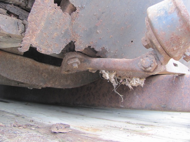

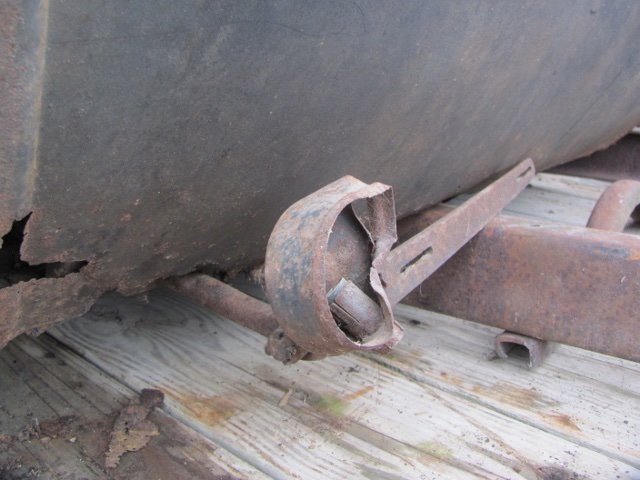

Here are some remains, an elec. tail lamp added, but is an early "15 touring with the 3 hole bracket w/ bolt on license holder, maybe had such a block before the rust out and termites!

Thank you, Dan and Rich... Looks like I have a woodworking project for this afternoon! :D
I'm noticing in the picture of the electric conversion that that 3rd hole is also bare - so it has me curious if it ever had a support there in the first place...
