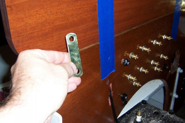

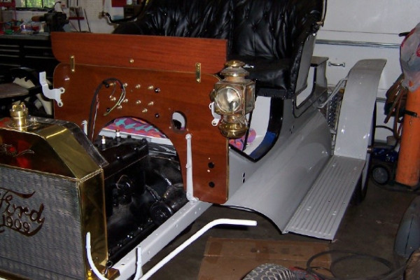

Like most antique auto restoration, parts, if not available, have to be improvised.
Did similar for the faux 09 roadster, took a reproduction later bracket with that bulge for the later rounded dash brass trim, and hammered it flat, then polish. Worked out OK for the project.

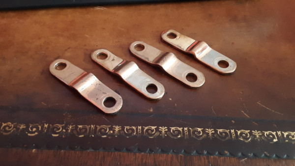

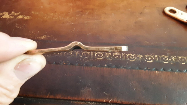

Bill, I have these that I believe came off of a 1911 T. They appear to be originals but I can't say for sure. The small hump in the middle is to clear the dash moulding. You're welcome to them for $20 if you'd like them.

First of all, I would not hammer the bump flat! Ridiculous. I would put the bracket in a smooth jaw vise and squeeze the bump out. Second, by doing so you are going to expand the distance between centers, changing the hole spacing. Why not make new ones?

Larry, I wasn't suggesting that they be hammered flat (and I'd object to buggering up something original!). And you're right, it would throw off the spacing for the holes. Going by pictures of Gary Hoonsbeen's original '11 and two other '11s pictured in Bruce's book, these are correct for 1911. Or at least part of '11. I don't know if they were used at all in 1910. The couple of close-up pictures of brackets in that book for 1910 look flat, and the brackets on the '10 that I had were flat. I just figured I'd offer them. Maybe some 1910 owners could chime in about the brackets on their cars.

- Posts: 4102
Re: Early T parts question
For those aghast of my modification of the later bump out brackets, remember I phrased the job was for the faux '09 I built! That means it was a fake '09, and so stated on a brass engraved plaque in the rear seat compartment. The frame was '20s, the engine was starter '23 and everything was between '09 and '27. Wood body and metal all reproduction.
There weren't repros of the correct brackets, so my fab was to modify.
Wanting it to look like an '09 which has the flat brass molding around the dash, flattening out the brackets was thing of the day
Should ever again build a '09, glad that R.V. will supply the factory correct brackets
