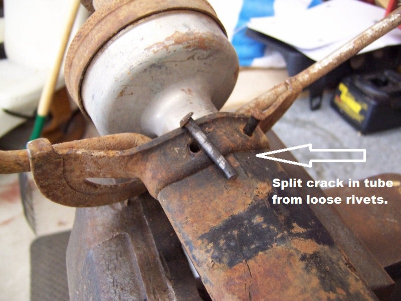

Sometimes that upper end of the barrel of the column is cracked or split, that will cause a wiggle that can't be fixed without repair to the column.

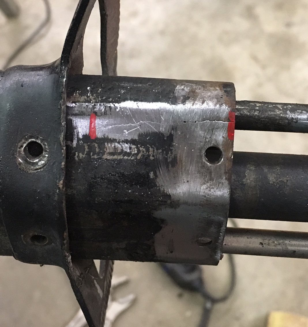

Oversized rivets didn’t take care of mine I took the cut off wheel and made one cut in the tube on the side about 3 inches long. Then tapped it together with a body hammer wire welded it and ground it flushed. Then reinstalled the quadrant, case and then reriveted it. Little bit of bodywork and done. Mine was probably an extreme case as the car was very used. Results may vary. Good luck with your project.

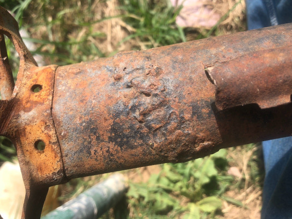

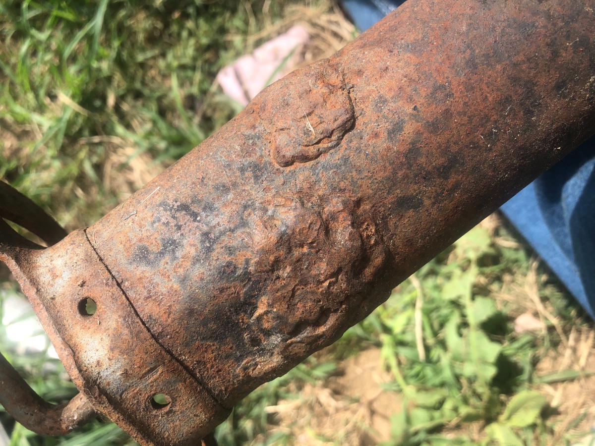

Somebody did some dirt dauber welding almost all the way around this one.

Found the crack. Welded and dressed a bit. Tightly installed new rivets. Good as new now.
