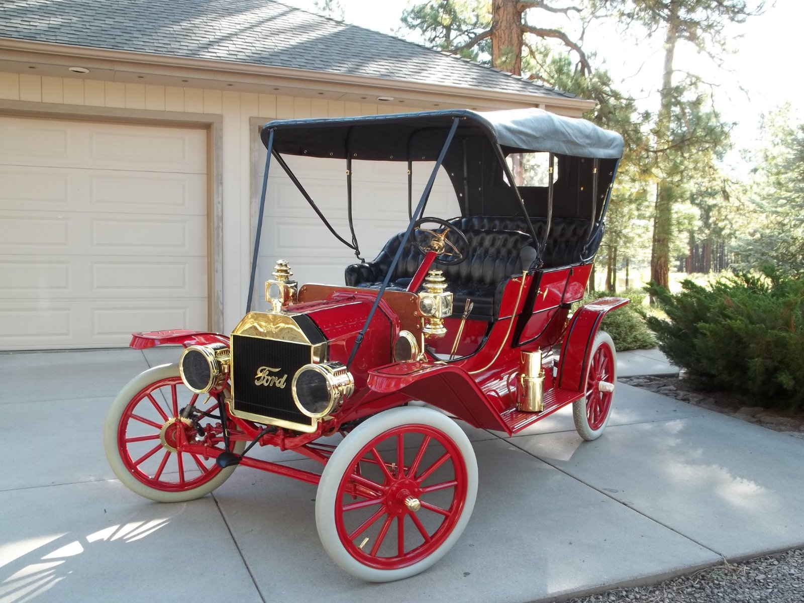

Here is another option for Carmine Red. My 1909 is painted with Nason Ful-Thane CG2911B, Red. I hope this helps. Russ Furstnow
