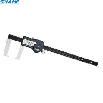

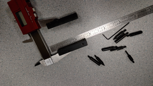

I have a caliper accessory kit to extend the reach of my calipers. It extends the jaw's reach to 2 1/2".
Topic author - Posts: 2980
- Last Name: Hjortnaes
- Location: Men Falls, WI
Re: What type of tool do you need to measure the size of a 4th main?
I did not know they made a caliper like this. Might be the way to go. Another suggestion came in to pull off the ball cap to see what the inside dimensions are. If worn, then a standard size would work to reduce the leak, even if the shaft is worn.
