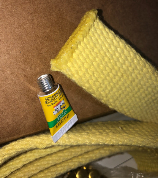

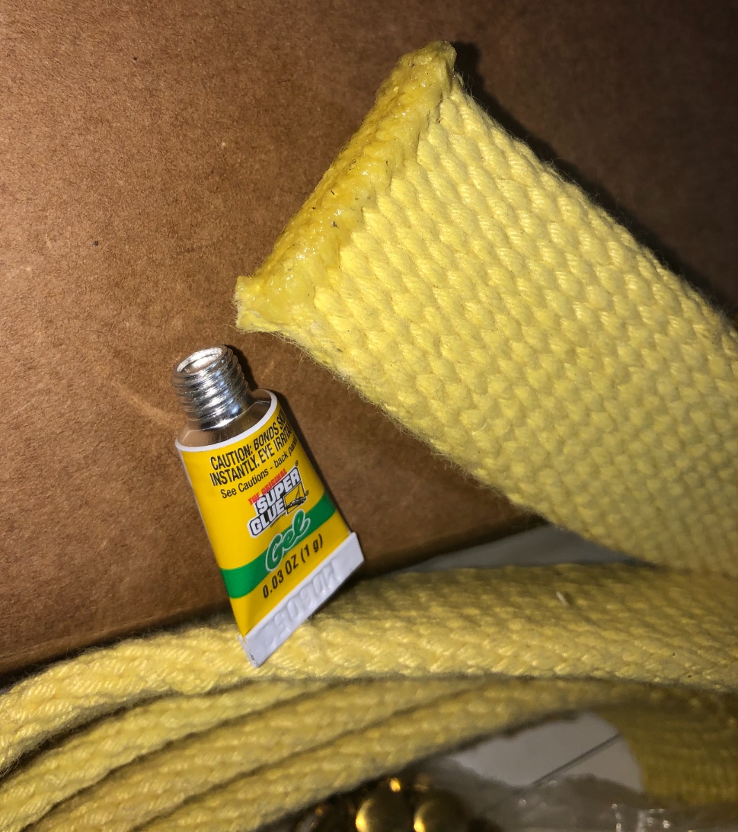

That info was in the instructions of a set of Nev R Wear just received. In my experience if you don't seal the fraying lints up. Have always used a few drops of Gel-type crazy glue across the width of those frayed ends to seal them.

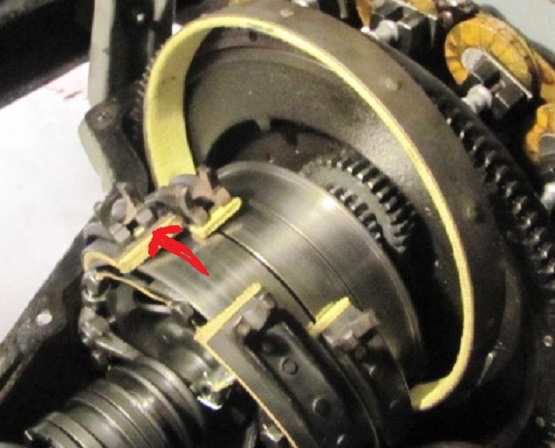

Never had any trouble, can't fathom harm to the drums, unless you're careless and use runny thin liquid crazy glue and let it soak into the underside of the Kevlar. The sealed ends are sticking up anyway since they lay just outside the bottom of the band lugs, there isn't any pressure on these exposed ends when the steel band compresses on the drum. You sure don't want the ends of the steel band to drag on the drum surface. That is why about 1/4" or so of the lining should extend past the band or lugs when you rivet each end first to the band.

Newly sealed Nev R Wear Kevlar ready to be installed.
Showing overhang of Kevlar

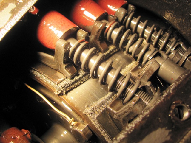

Those Nev-R-Wear are good linings to use.
This is what those same in the above photo Kevlar linings with sealed ends looks like after 4 years in.

"Four years in"? Really? Great picture Dan, but are you sure you grabbed the right photo? Looking at the ends of those bands in THAT photo, they look brand new and perfectly dry to me! Maybe just my old eyes tho'.....
