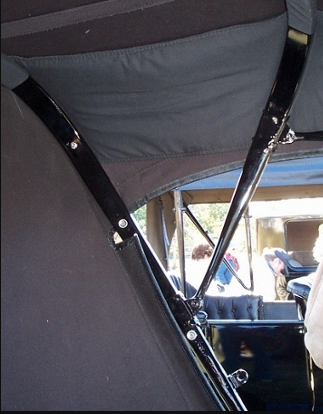

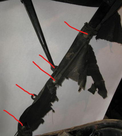

I have two photos that originally came from Dan Treace. While these are a good reference I am hoping for measurements prior to drilling holes in new top irons.

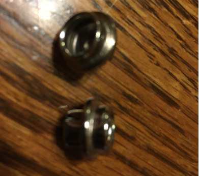

In regard to the fasteners, I may have found something close to original. There are the top snaps from the top of the Model A windshield. While they lack the spring loaded cover, it still retains the two prongs of the fastener and has sufficient shoulder for the side curtain grommet. The missing spring loaded cover is not visible when the top is stacked or when it it is up.
model a windshield snaps.png (246.55 KiB) Viewed 4508 times

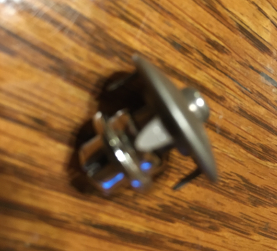

As received, the fastener hole was undersize and would not accept the snap. I enlarged it using a small socket and my vise.
snap engaged.png (246.54 KiB) Viewed 4508 times

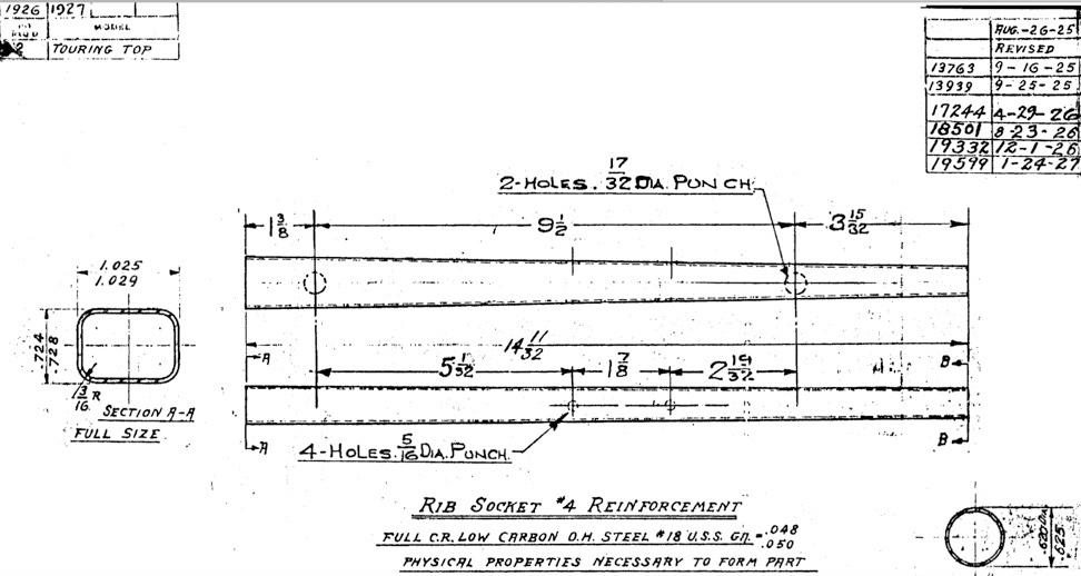

Since you have new bow irons, they maybe a tad off original dimensions. If made proper lengths, then this Ford print for the touring may assist, as the rear bow is similar.
Source: MTFCI webpage, Technical Information. 1926-27 Top bows.
IMO, the better way is to first have on hand the new side curtains, and rear panel to place first to be sure the fit is tight when you fit the sockets to the top irons, and the side curtain too. Then make the holes into the new metal irons, and at the same time fit the curtain fasteners to the fabric curtains and rear panel to align with the new sockets in the irons.

Dan, thanks for the touring print. I have a set of,26-7 Touring top irons and they appear to be different to the point where I would be more comfortable with reference dimensions off another roadster. I may also try the Benson Ford to see if I can find a print.

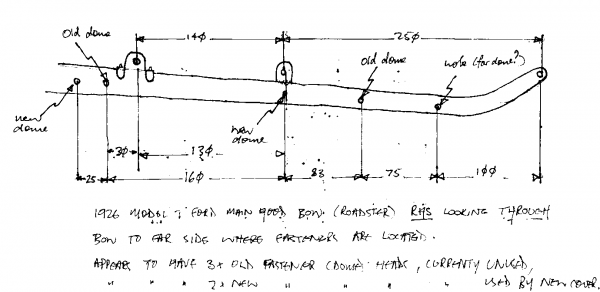

See the drawing below. Is this what you were looking for?
I hope it's clear enough - unfortunately I was struggling with low light due to some faulty fluro tubes so the sketch isn't as good as it could be (and it just 'grew' rather organically).
With my car I discovered that there appeared to be 3 original dome fasteners (one of which was just a small hole where I guess a rivet/screw would have gone through), and two new ones - the latter fitting the new top that's on the car. I've differentiated these in the drawing.
To be clear; the dimensions are in mm, and the drawing is looking from the outside of the RHS bow through to the fasteners on the inside. I hope that makes sense? Please let me know if there's anything else you need, now I've got the hood partly up it's not too hard to take some more measurements.
Also, I will try and improve the light in order to have a better look tomorrow, or the weekend and will update if I find any anomalies - the old adage "measure twice, cut once" springs to mind!

Tom, in case you are not familiar with converting mm to inches...
Inches = mm/25.4
For example, the 250mm dimension in Luke's drawing would be 9 27/32 inches.

Luke,
Thank you! That’s exactly what I need. Thanks for including the reference dimensions back to the mounts.
I appreciate you making the journey to measure your car.
