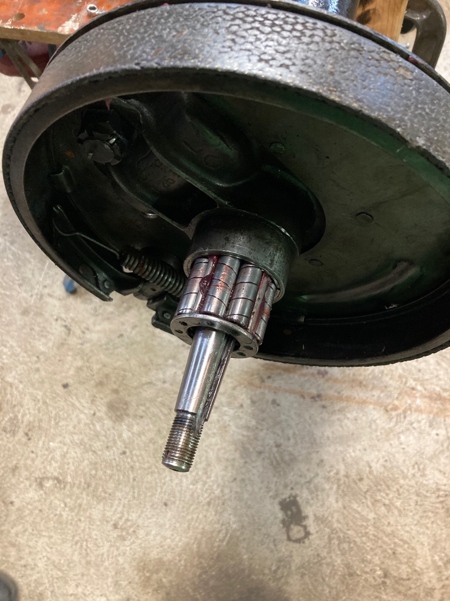

I am test fitting the rear axle outer bearings during a rebuild. I have new axles, new (“best quality”) bearing sleeves, and bearings that are essentially NOS. They do not just slide in like I am accustomed to and take small taps from a rubber mallet to fully seat them. When they are half way in, the axle turns freely and the rollers spin. Once they are fully in, the axle spins freely with no binding.
Is it normal to have to tap the bearings into place? I am used to just sliding them in and out but wonder if that’s because everything was worn out.

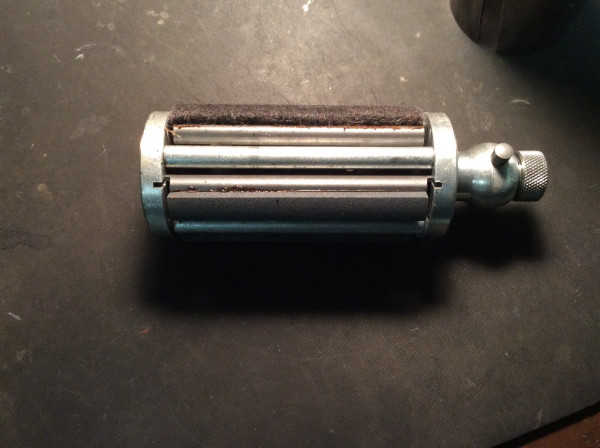

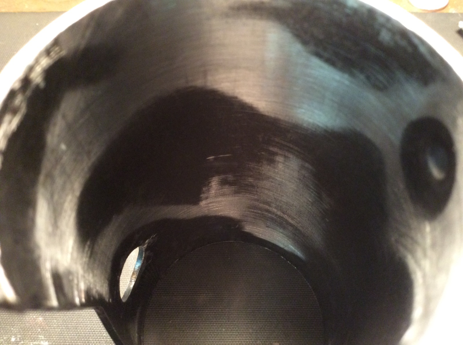

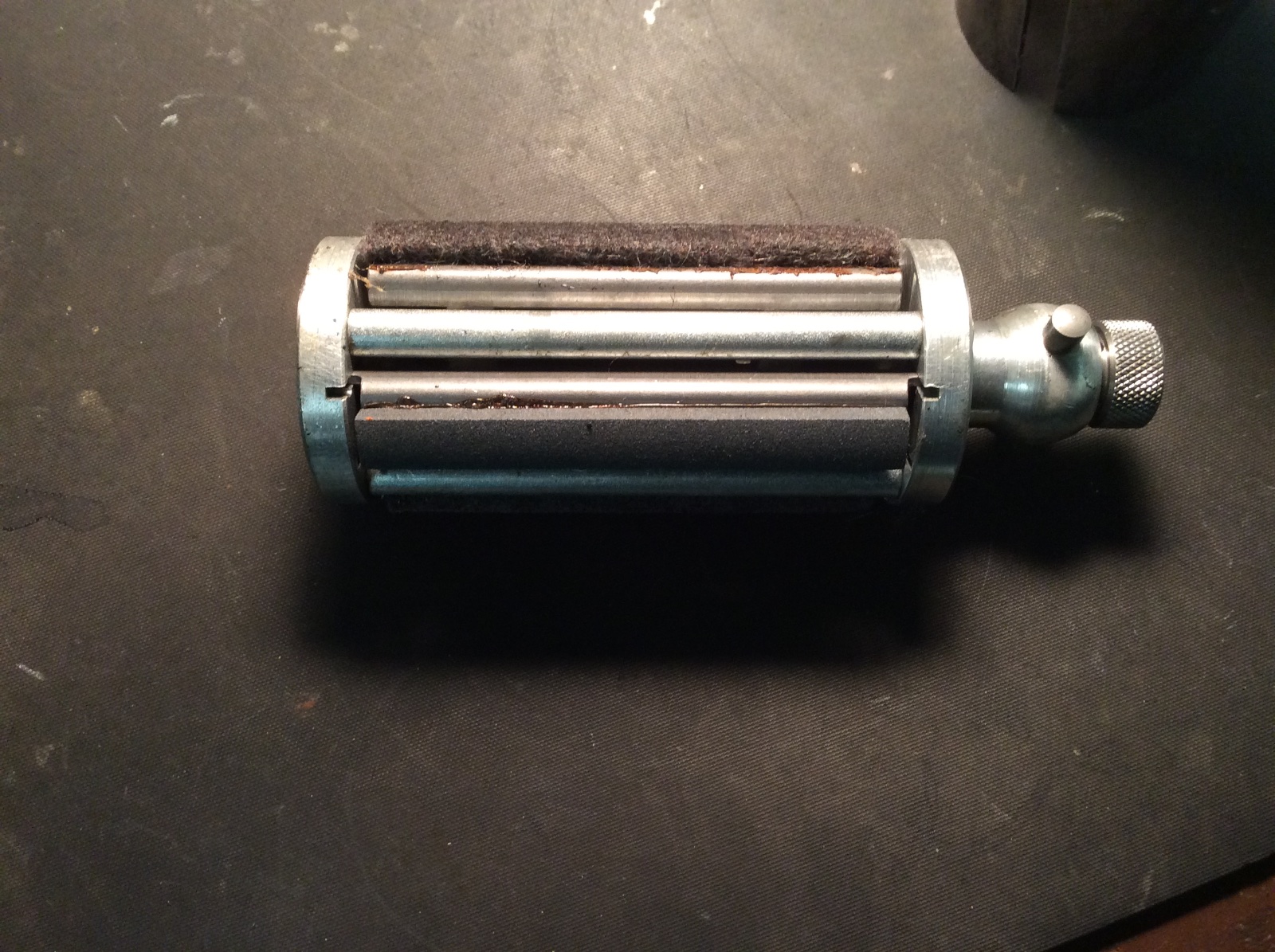

I used an Ammco cylinder hone. I found the sleeves to be right thickness but uneven surface. That gave a nice sliding fit.
