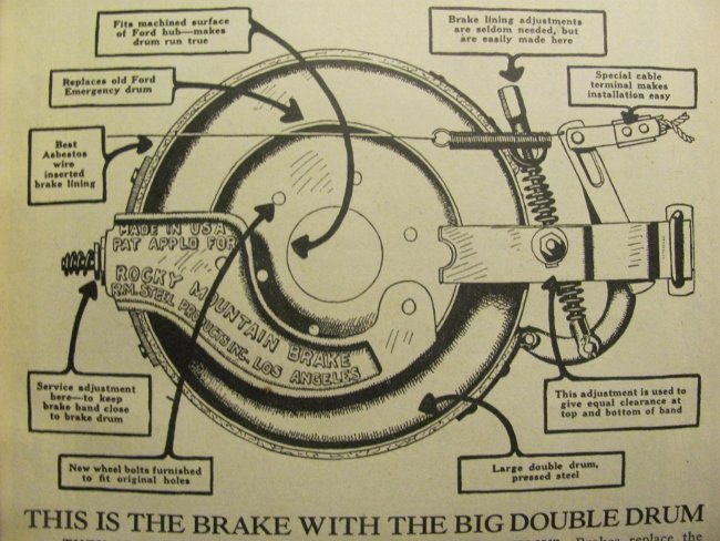

The current reproduction Rocky Mountain brakes available from the vendors have the outer band anchor point located at one end of the band to provide more self-energizing braking power going forward than in reverse (self-energizing is when the motion of the drum pulls the band tighter against the drum).
https://www.modeltford.com/item/RMB2.aspx
Original and older reproduction Rocky Mountain brakes have the outer band anchor point located at the midpoint of the band (like the current AC brakes). This provides equal stopping power in forward and reverse since only half of the band is self-energizing at a time.

Post by Original Smith » Wed Aug 19, 2020 9:05 pm
Original Rocky Mountain Brakes are pictured above. I have them on all of my cars. The current Rocky Mountain Brakes are not Rocky Mountain at all, and I believe the outside diameter of the drum is less than the original. The bottom line is, if you are going to make a reproduction, do it correctly, or don't do it. The first issue brakes were close, but the owner of the company didn't do his research as I have, and used a Bennett brake equalizer, which works in the opposite direction than a true Rocky Mountain. It pays to do your homework when reproducing something, but many in this hobby don't do that!

Post by Jonah D'Avella » Wed Aug 19, 2020 9:55 pm
I hear that If you adjust RM brakes right, they work fine in reverse.

The current Rocky Mtn brakes ARE copies of the 1926-27 AC brakes. The 1926/27 AC brakes didn't use the center anchor point. While I still have 30X3-1/2 on the front of my 1921(still original steering ratio), I went with the big drum and Rocky Mtns on the rear with 21" wheels to get more rubber on the ground. Have 3 braking systems; parking, RM's and transmission. I made my own equalizer that works independent of the parking brake. I did use a set of original AC small drum brakes on the 21 before putting the big drum setup on for a while, they worked good. Those AC's cable activated brakes are now on a friends roadster, still working good. The 25 is getting a set of Bennett shoes as soon as I repair and reline them.
