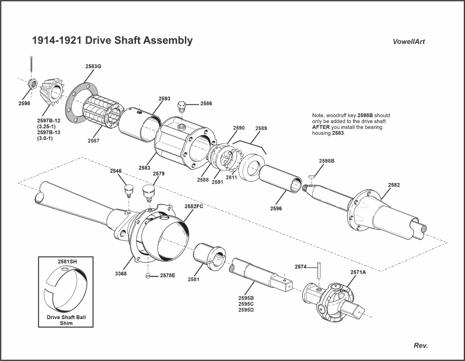

***1914-1921 Drive Shaft Assembly***
- Posts: 2920
- Last Name: Hjortnaes
- Location: Men Falls, WI
Re: ***1914-1921 Drive Shaft Assembly***
2586 does not exist on my cars
please include bolts that go into 2583
Otherwise it all looks good.
- Posts: 5442
The 2586 would have been used on all closed spool housings. It retains the pinion bearing sleeve. 1921 back would have used studs not bolts.
Edit re 2586;
Except the early housings that were babbitt.
													Edit re 2586;

- Posts: 3821
- First Name: Larry
- Last Name: Smith
Since when does the cast iron housing use bolts? They use studs and castle nuts!
Small change
The reason for this change was because to show the differences between the 1918 and 1919, I'd need to draw a completely new drawing for those small plugs that cover the pin holes for the U-Joint. Just didn't think it was worth it...so I made a notation instead.

- Posts: 3821
- First Name: Larry
- Last Name: Smith
Like everything else, do your research before posting on the forum!
Larry, that's exactly WHY I do post to the forum. My research is limited, you guys know a hell of a lot more than I do, sooooooo, I post here, so you and everyone else can help to make them correct.
