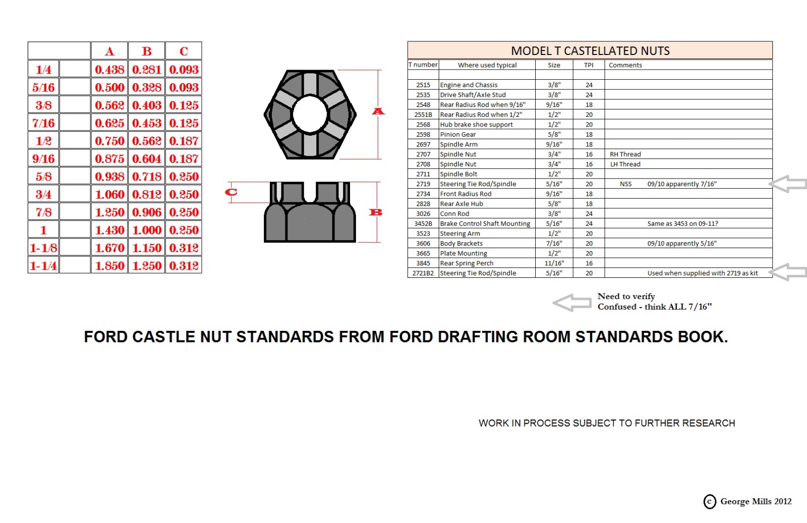

Re: Castle Nut Assortment set?
Ignacio,
I started the makings of a 'helpful book' on Model T and kept getting side-tracked after having a hundred or so individual pages that never got around to being collated.
Here is a list of castellated nuts as used a T....sorry I never got around to quantity but there are prob a bunch who could offer up quantity from their heads.
The dimensions shown are from the Ford standards for castellated nuts. I'm just not sure what year for the standards I referenced but it was well before the Model A era and I've never gotten around to proving the info. Yeah, I know, they interchanged with flat bottom slots a bunch too, so who knows...
Have fun
Have fun

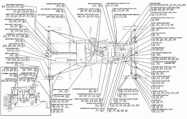

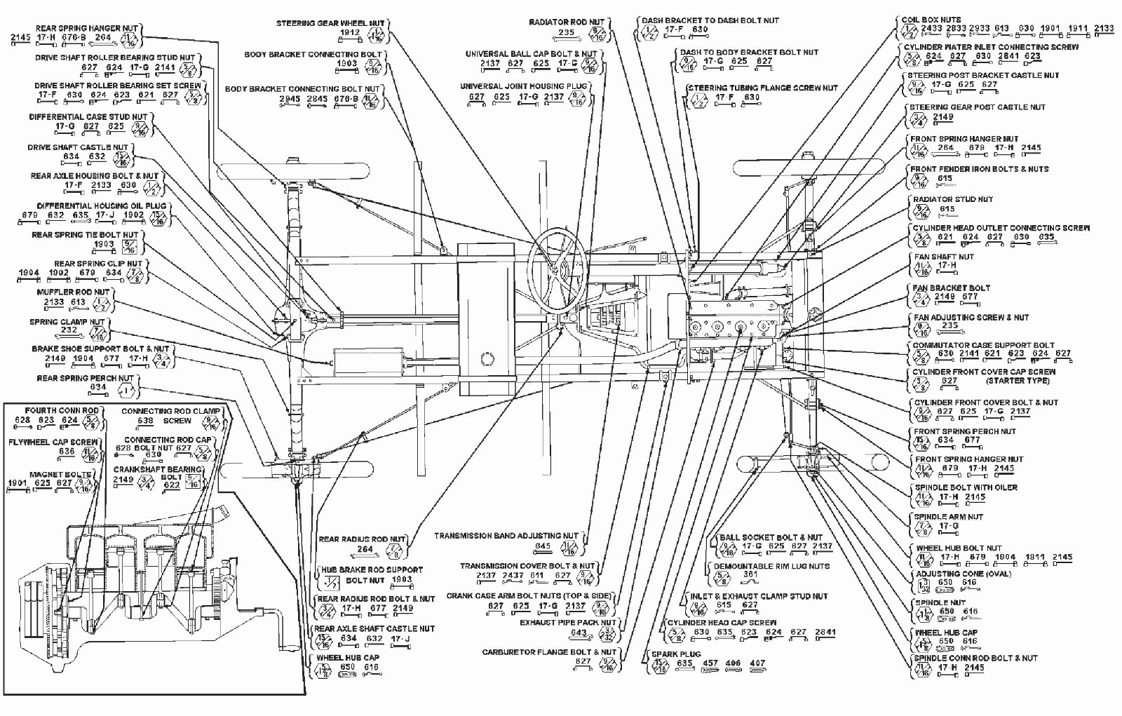

This is a link to an earlier discussion this year and contains a spreadsheet of nuts & bolts by application https://mtfca.com/phpBB3/viewtopic.php? ... eet#p90892 (right click on image to enlarge it)
You could also use this diagram to make your to make a list
